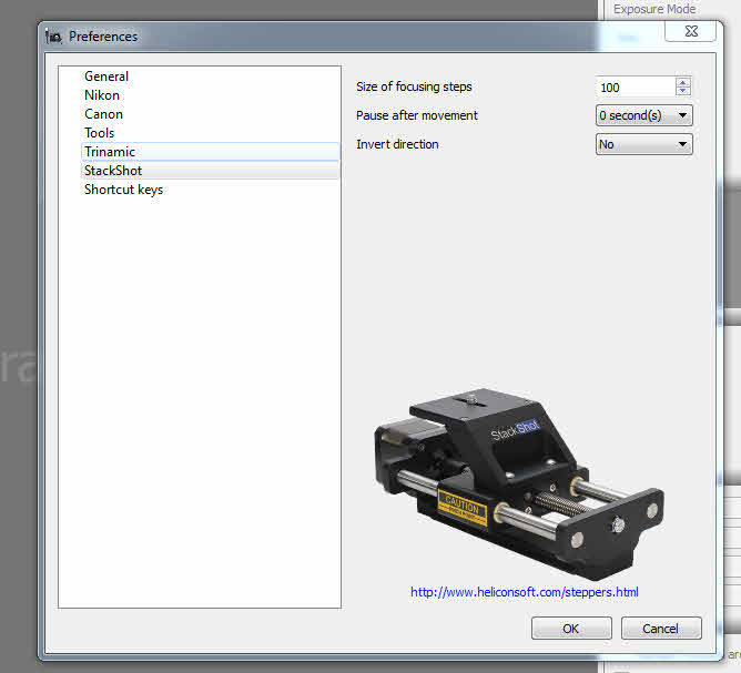

you mean - there is no control of the StackShot device in Helicon Remote and the menu in the "preferences" is NOT working (see attached jpg)? I am confused now.

Sorry for confusion. Helicon Remote will not work use StackShot unless connection with camera is established. This will not work with your Panasonic camera.

I think it is not wise to connect the camera remote control so tightly to the rail control. I have a StackShot with USB control but NO camera that you are controlling: nevertheless I need the remote rail control. You will defenitely limit the number of users which would like to use your software.
Zerene Stacker obviously follows a different strategy which is more flexible here.
If this is your final word I will have to abandon your software - it is a pity that I had been deceived by the user interface of Helicon remote.

There is not much sense in Helicon Remote if you are not able to see live view image from your camera. That is why we need connection to the camera. We can control StackShot without the camera, this is no problem. But this gives you no advantage, you can do the same with StackShot control box. Right now we support Canon and Nikon cameras. We want to support other types, but they do not provide interface to get live live and control focus. If I missed something, please correct me.
