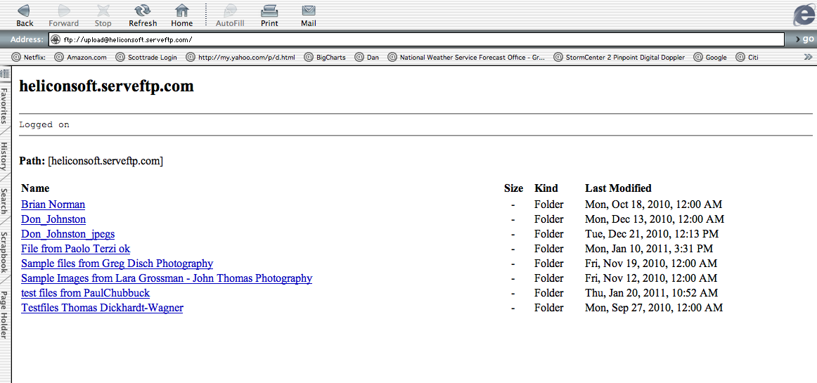

I hate to be a bother, but I have never used an ftp client before. When I use your url, I get this window (see attached) showing a list of other folders but there is no way for me to add my folder to it.
- Picture 3.png (103.3 KiB) Viewed 8007 times
Re: Bug in recent Helicon Focus update
Please try this free FTP client:
http://filezilla-project.org/download.php
