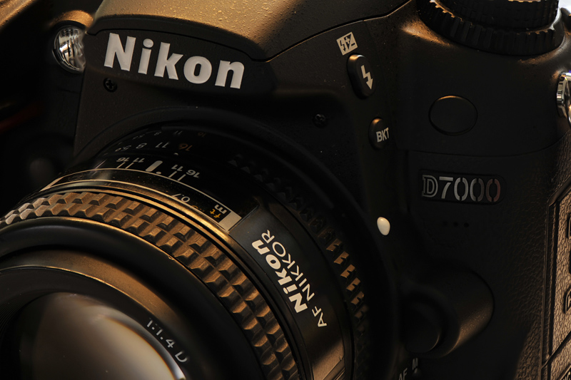

Well,
the remote Version: 2.0.15.m.7abc6f04f892 is working with the D3 too!
Settings on D3: Menu System / USB to MTP/PTP
AF to Single, AF on the lens on
So thanks, Stas for the great work!
first try was this, without any retouch 59 pictures
Remote and Nikon D3
Remote and Nikon D3
- D7000#.jpg (199.53 KiB) Viewed 8505 times
