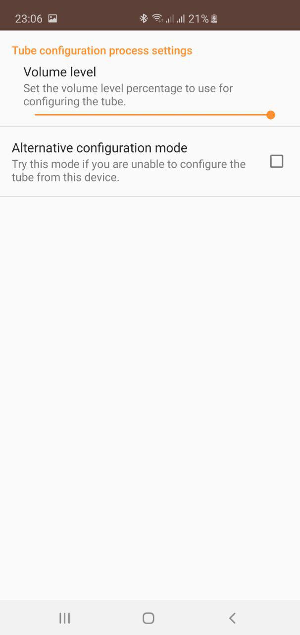

Please plug the cable in, then please check that the media volume is set to max. It's important to check it with the cable being already plugged in.
Then please run the configuration app and call the menu.
Tap Settings
Tap Settings and set the Volume level to max
PLease let us know if this helps.
Tap Settings
