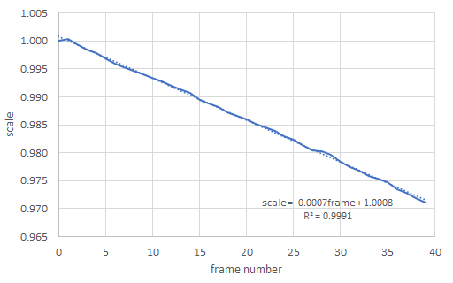

Er, except stacks don't actually have to be rendered in the same direction to be marked as compatible. Because automatic alignment flips the direction for each new output, doing method B+C+B produces two B outputs having the same direction, a C output having the opposite direction, and the last B and C are seen as compatible for retouching. The opposite directions mean probably there is some difference in their alignments and retouching won't work very well, but Helicon is thinking they are compatible even though it decided the C and the first B are incompatible. This is a variation on other forms of incorrect output compatibility detection I mentioned earlier in the thread. So there are bugs in the compatibility detection logic.
The stack is sorted consistently. It is, after all, an autofocus bracket. I'd have to manually renumber the frames to put them out of order. The difference is Helicon has strong reactions to minor deviation in the first frame where the other stackers are relaxed about it. For the example plotted below, the magnification reversal results in a 0.65 pixel stretch at the extreme corners of a single frame. Which, for most stacks (I'm tempted to say basically all of them), will have negligible effect on the depth map.
P1090750B alignment.png (11.27 KiB) Viewed 5844 times
This is why I suggested making automatic sorting more robust by considering the balance of evidence and not flipping orderings between outputs using the same frames. I mean, I know exactly what I'm looking for between the first two frames and there's no way to see it at 100% as the only bit that's in focus is halfway between the center and corner. It is therefore moving only a third of a pixel on the LCD.
Sure, I now know how to diagnose, avoid, and work around this and that helps people who happen to find and read this thread. But probably not many will and I would be surprised if many Helicon users have the ability to measure frame scaling. Since the code paths already exist to display a warning on unexpected scalings of, say, a couple pixels and errors on larger ones the possibility of more user friendly behavior seemed worth mentioning.
