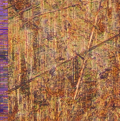

I'm having issues with method A stacked images. I'm stacking around 80-100 TIFF source images with method A, but the output image on several of my stacks has an unusual purple "barcode" like artifact on the left edge of the stacked image. I do not get this result when I try the same source images with Method B or C.

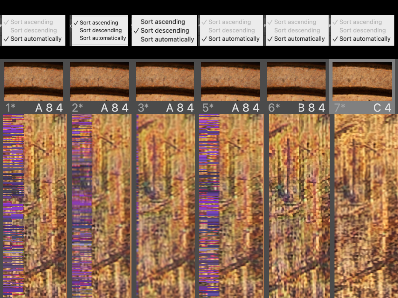

Hello,
Thanks for the quick reply. Regardless of whether I had auto, ascending or descending, the issue always seems to appear when I use Method A rather than when I use Method B or C (see image below.) (Note: the "sort descending" image below has a 1-2px purple artifact on the left side of the image, significantly less than the other sorting methods, but only method B and C did not have the artifact for some reason.)

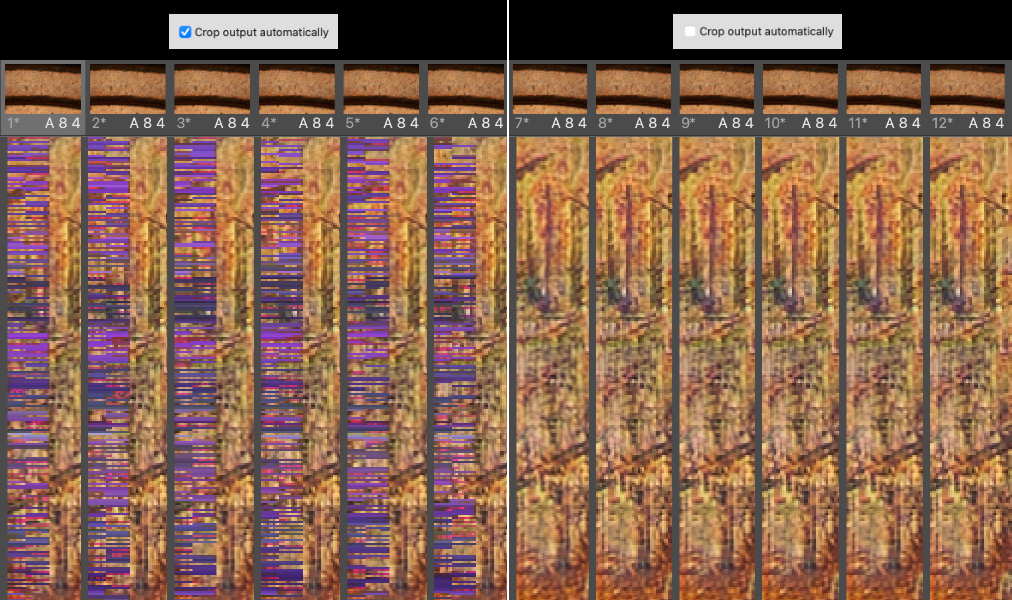

I ran some tests with other settings to determine if they might be related. I discovered that if I had "Crop output automatically" selected OFF, the problem disappears. I ran the same stack 12 times (six times with crop output selected on and six times with crop output selected off.) The "Crop output automatically" selected OFF never had the issue.
