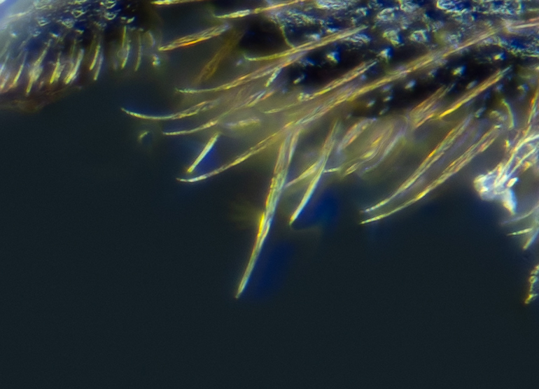

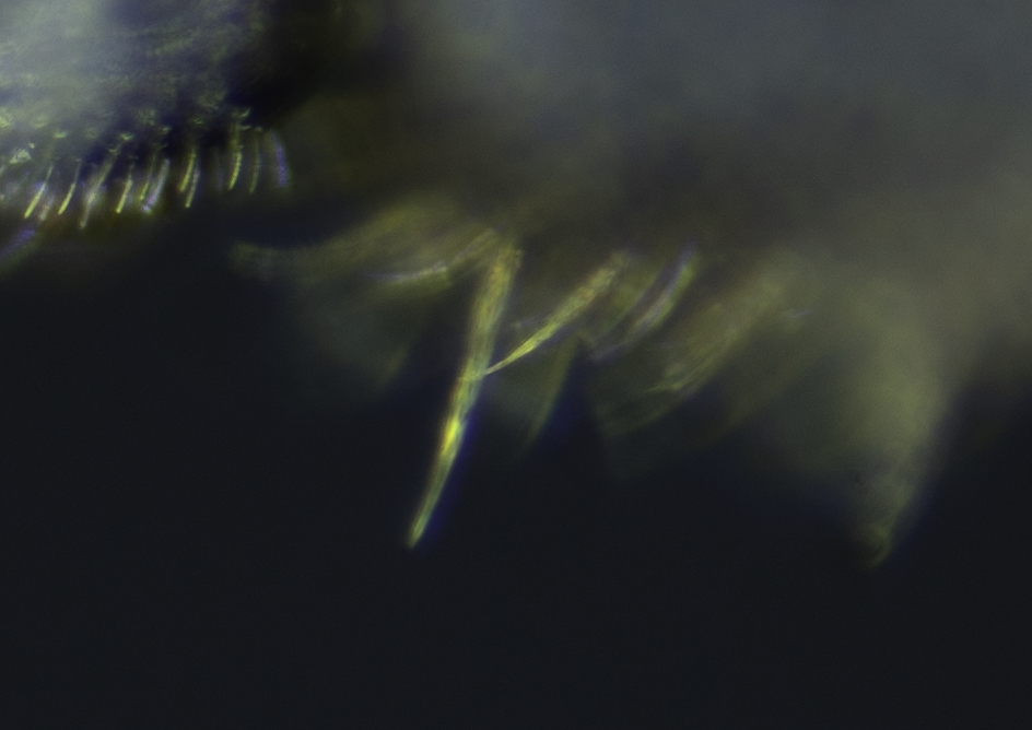

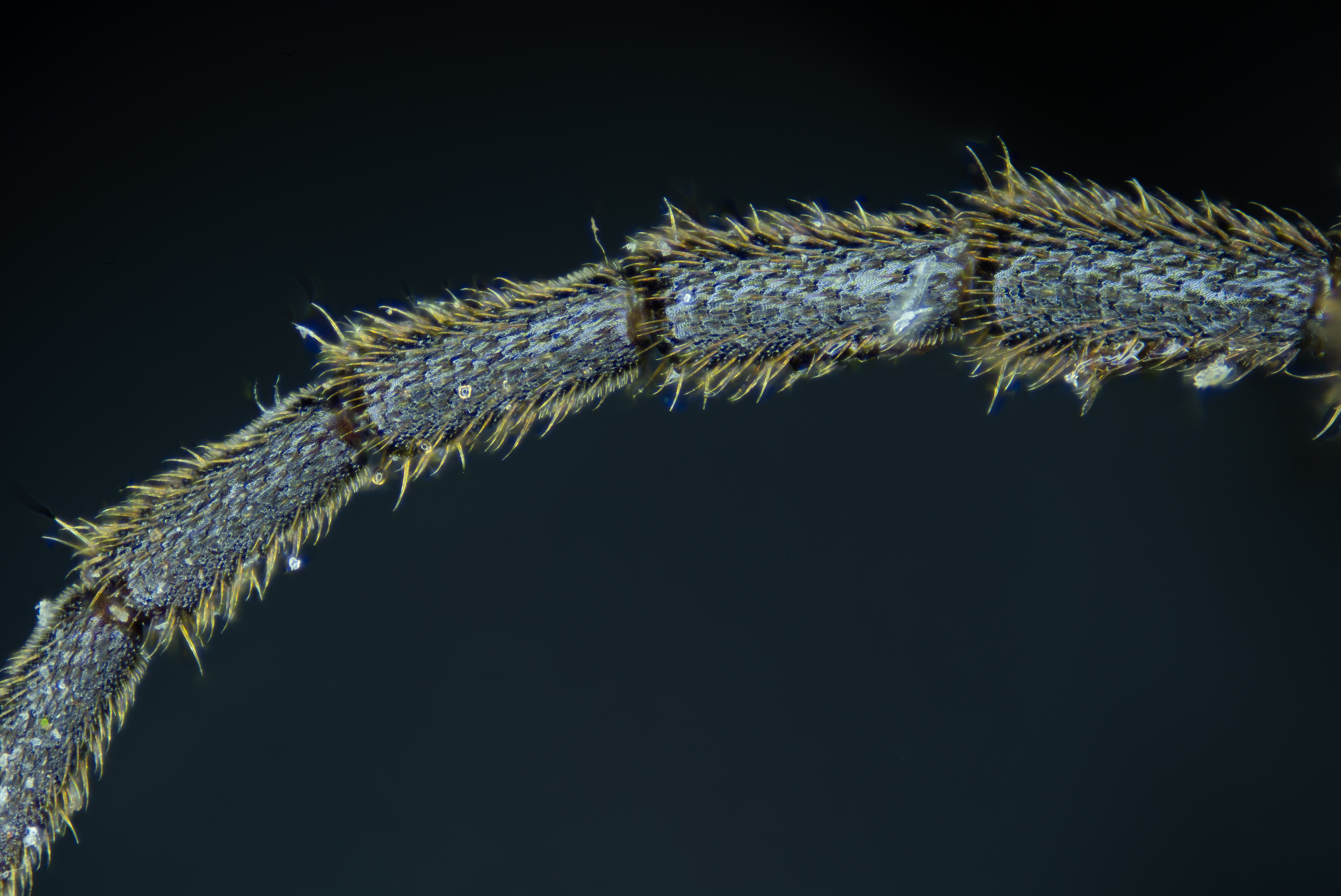

I was wondering if someone would be able to help me with a stack i'm currently working on. My setup is the Wemacro tube with raynox 150 reversed with a 10x plan objective. it's mounted on a focus rail and I'm using 8 micron steps. my subject is a beetle and I photographed the antennae. I took a total of 128 images.
i've tried several stacking methods and I can't seem to get a clean final image. i've attached one of the final stacked image and a couple of crops of an area that shows diffraction spikes in the final stack, but in the original raw you can clearly see that one hair is clean
the images has tons of halos and I'm not quite sure how to process this image. any advice would be really appreciated. if anyone happens to be interested in giving the stack a try, I can upload 50 some odd images to dropbox and supply the think if anyone wants to experiment with it.
thank you.
full stack:
(7.92 MiB) Not downloaded yet
crop of full stack:
A7V03479-B,Radius4,Smoothing4 copy.jpg (253.77 KiB) Viewed 33640 times
crop of original raw:
A7V03479-B,Radius4,Smoothing4 org.jpg (469.47 KiB) Viewed 33640 times

There is significant chromatic aberration, so while the hair is clean, it's essentially de-focused. There is also significant blurring of the adjacent out of focus hairs, these two effects probably contribute to the final image. But yes, the spikes do look odd. Have you experimented with different rendering methods and parameters? Can you upload one sample focus stack that demonstrates the problem for us to try ourselves? You can upload it to our private storage.

I'm having similar issues and here are my findings:
  • with a complex structures under high magnification (I shoot x5) if you do not cover the whole depth of the whole structure, Helicon cannot differentiate between an object and the background. Because the depth is so shallow at that magnification it actually sometimes confuses a blurred (out of focus) object for a part of actual object. I would think this is what happened with the hair on the top and bottom of the leg
  • For the tiny elements like hair in your mid leg part where hair almost blend into the leg and do not have much of depth I found that surprisingly smaller steps between photos do not solve that issue. However I noticed that good light that provides higher contrast helps sometime but it can still struggle with translucent elements
  • I noticed that for such a complex objects Method C seems the most reliable but stil produces artefacts
Long story short it drives me crazy sometimes, and I end up manually cleaning those in Helicon but I would love to have some sort of easier solution for those halos / artefacts
