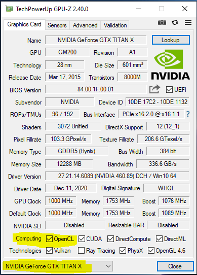

According to GPU-Z, openCL support is available for the card:
download/file.php?mode=view&id=1259

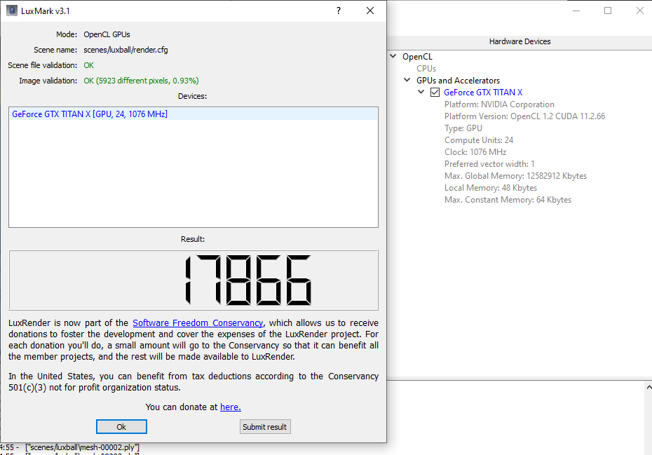

and it run's still fine when being stressed with Luxmark OpenCL test:
download/file.php?mode=view&id=1261

normal openCL performance
Luxmark 3.1.PNG (42.72 KiB) Viewed 5630 times

OpenCL is available
OpenCL is available
GPU-Z 2.40.0.PNG (41.2 KiB) Viewed 5630 times

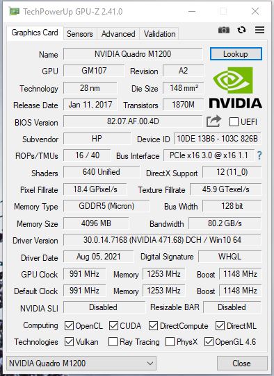

I have the same issue with a Nvidia Quadro M1200 (Windows 10), which I believe is also based on the Maxwell architecture. Will this be supported also in the new update?

fdisilvestro wrote: 17.08.2021 11:37 I have the same issue with a Nvidia Quadro M1200 (Windows 10), which I believe is also based on the Maxwell architecture. Will this be supported also in the new update?
We have added support for all the missing Maxwell 2.0 GPUs (GM2xx) - Quadro, Tesla and Titan. But your GPU is GM1xx - Maxwell 1.0, it's an older architecture that's incompatible with Maxwell 2.0. We can't support it. Sorry.
