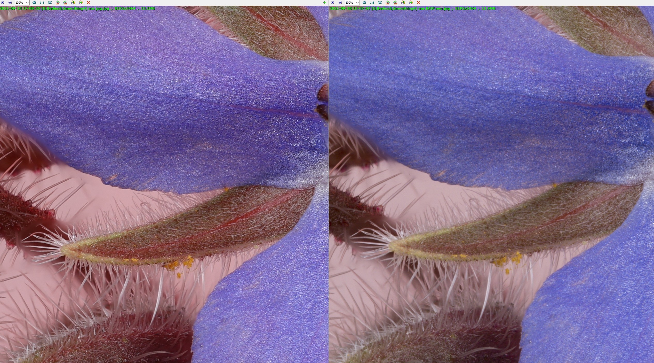

When I generate an image out of .cr3 files the result is less sharp and less saturated as an image out of .jpg files (see attachment). Where is the problem?

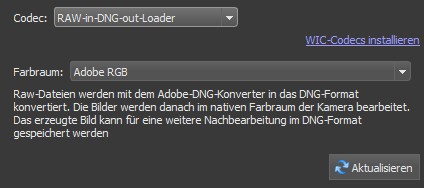

3. Cr3 stack processing: please let me know what codec is selected in Raw development settings.

3. see attachment

3. see attachment

If I convert the RAWs (Canon Compressed RAW) by hand with Adobe-DNG-Konverter the DNGs look exactly like the original RAWs.

Your jpg's are sharpened in camera, note the 4,2,3, under the Strength, Fineness, and Threshold icons, these are "Unsharp Mask" settings/features. And, although contrast, saturation, et al. are at 0, there is still some applied to your jpg/heif files. That is why your jpg has better color tone compared to the Raw. You probably already know this, but it bears repeating for others, those settings only effect jpg/heif files and not Raw. Raw files are pretty flat and generally need post processing.
