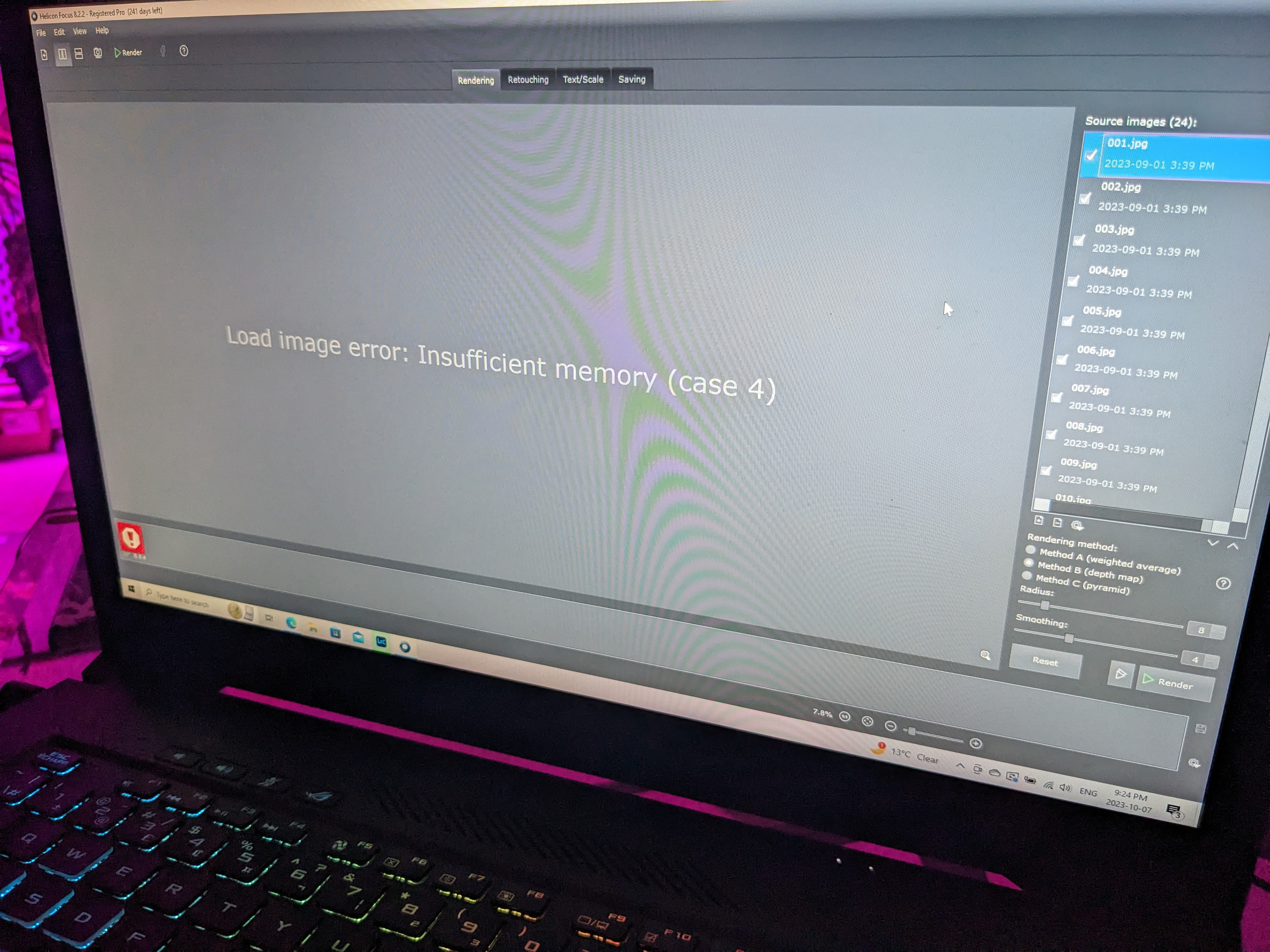

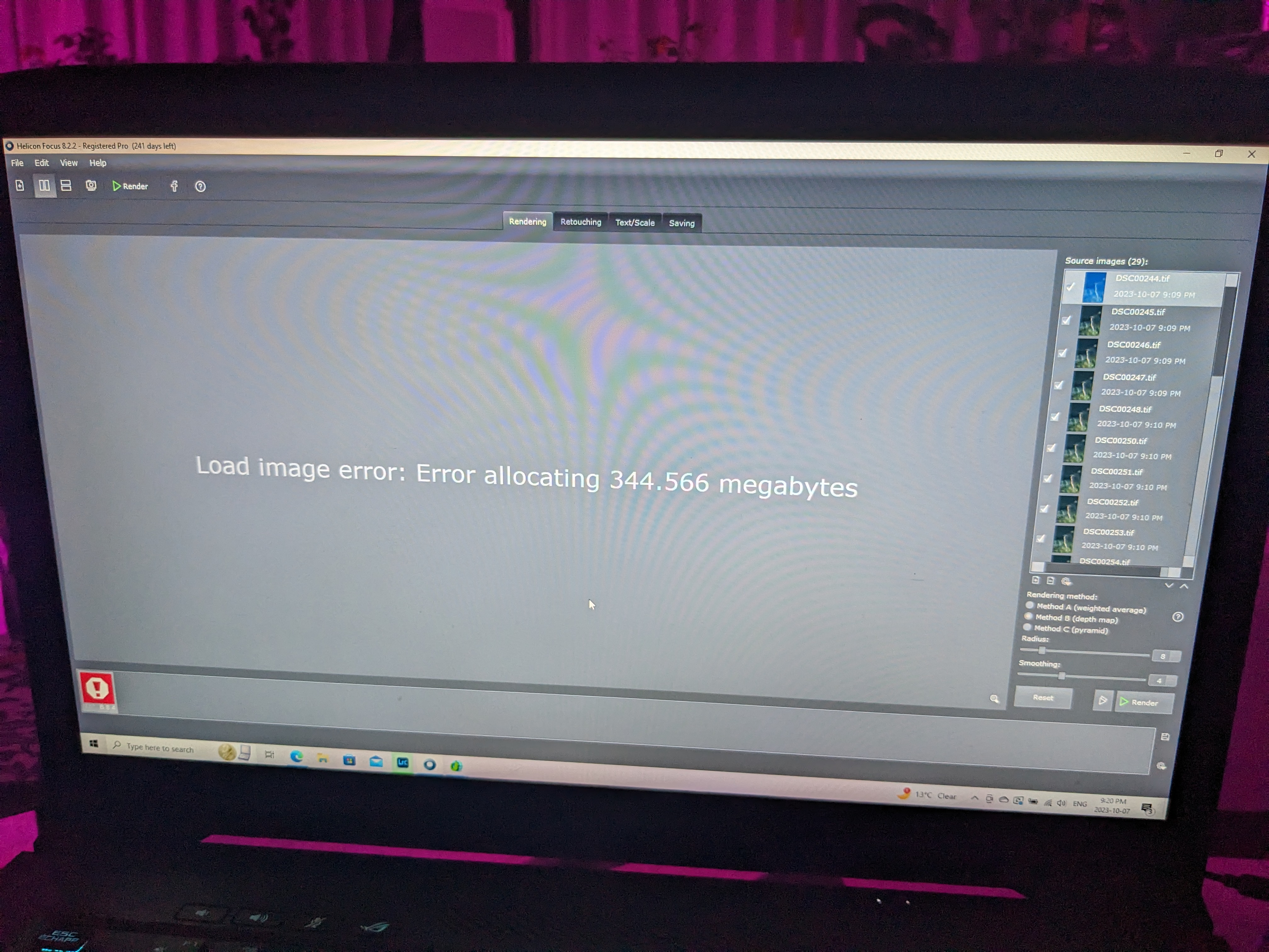

Computer has been formatted a few times and still getting these errors pretty much every time a render is attempted. The disk is not full where the software is located and saving. Unsure where to go from here.. no other post seems to have helped with this issue. It used to work and be able to render 160+ photos. It seems to work with small stacks of 3-4 photos but getting a red triangle at the bottom of the screen.

Hello,
The error is about RAM, there wasn't enough of it. It was probably taken up by other software, but it doesn't look like you've had many other programs running. It could also be caused by the page file size being too small. Follow this article and make sure the page file is set to at least 8 gigabytes (8192 Megabytes), better yet - 16 (16384 MB, but the exact number doesn't matter, just has to be thereabout).
