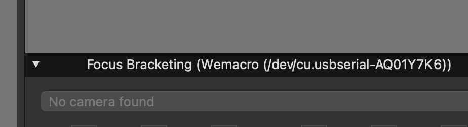

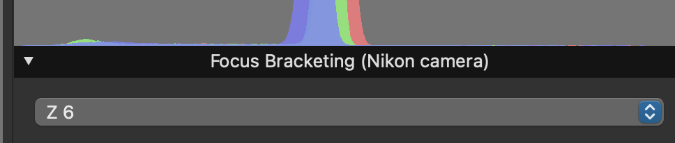

When I use my Nikon Z9 (with Mac-Sonoma 14.3) I can connect both the camera and WeMacro together and use WeMacro.
When I connect Nikon Z6 I can either:
- Use in Nikon mode without problems
- Get the error "Camera not connected" when in WeMacro mode.
What do I do wrong?

Camera (Z6) not found
- Skærmbillede 2024-02-08 kl. 13.52.56.png (24.24 KiB) Viewed 12178 times
- Skærmbillede 2024-02-08 kl. 13.54.54.png (19.23 KiB) Viewed 12178 times
Re: Camera (Z6) not found
Hello Per,
Please send a bug report (menu - Help - Report a bug) when the camera is connected and you get "No camera found" as shown on the screenshot.
