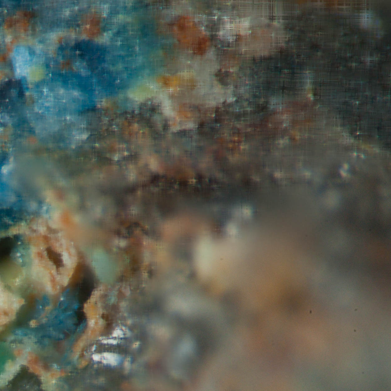

I have a weird artifact showing up with Helicon stacks on only one of my microscope objectives.
Optics:
Nikon D3
Nikon 200mm, f/2.8 manual focus, set at f/8 infinity focus (as a tube lens)
5X Mitutoyo Plan Apo Infinity Corrected Long WD - works great
10X Mitutoyo Plan Apo Infinity Corrected Long WD - works great
20X Mitutoyo Plan Apo Infinity Corrected Long WD - exhibits this crosshatch artifact in Helicon stacks most of the time
Homebuilt stacking stepper - set at 2.5 micron steps for 20x, 3.5 microns for 10x, 10 microns for 5x
Nikon flash through diffusion paper for illumination.
Input Images:
I'm taking photos of micro-crystals. I have separate dust maps for each objective, which I enable in the Helicon UI. The 5x and 10x objectives almost always produce great results with the default Depth Map stack parameters and a bit of retouching of the out-of-focus areas. With the 20x objective, though, most stacks show this cross-hatch pattern in the sharp areas (which is obvious in the image I've attached) but absent in the source images. It does not seem to matter what stacking method or parameters I select. The source images look fine to me with sharpness that appears where expected.
The attached image is a cropped section that shows the artifact clearly, not the entire image.
Questions:
Any idea what is causing this cross-hatch pattern?
Do I have a bad objective?
Maybe I am exceeding the capability of my optics?
Maybe there's some interference between my step size and the depth of field?
I'd really like to be able to use this objective for its increased magnification, but the results aren't usable unless I can figure out a way to get a cleaner result.
Thanks in advance for any ideas or guidance.
(176.57 KiB) Not downloaded yet

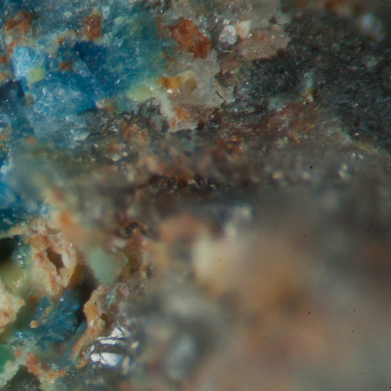

Thanks for the suggestion, Catherine. Ive added another Helicon stack image to this post without the dust map. The crosshatch is gone. Guess I'll have to clean my sensor.
(196.93 KiB) Not downloaded yet
