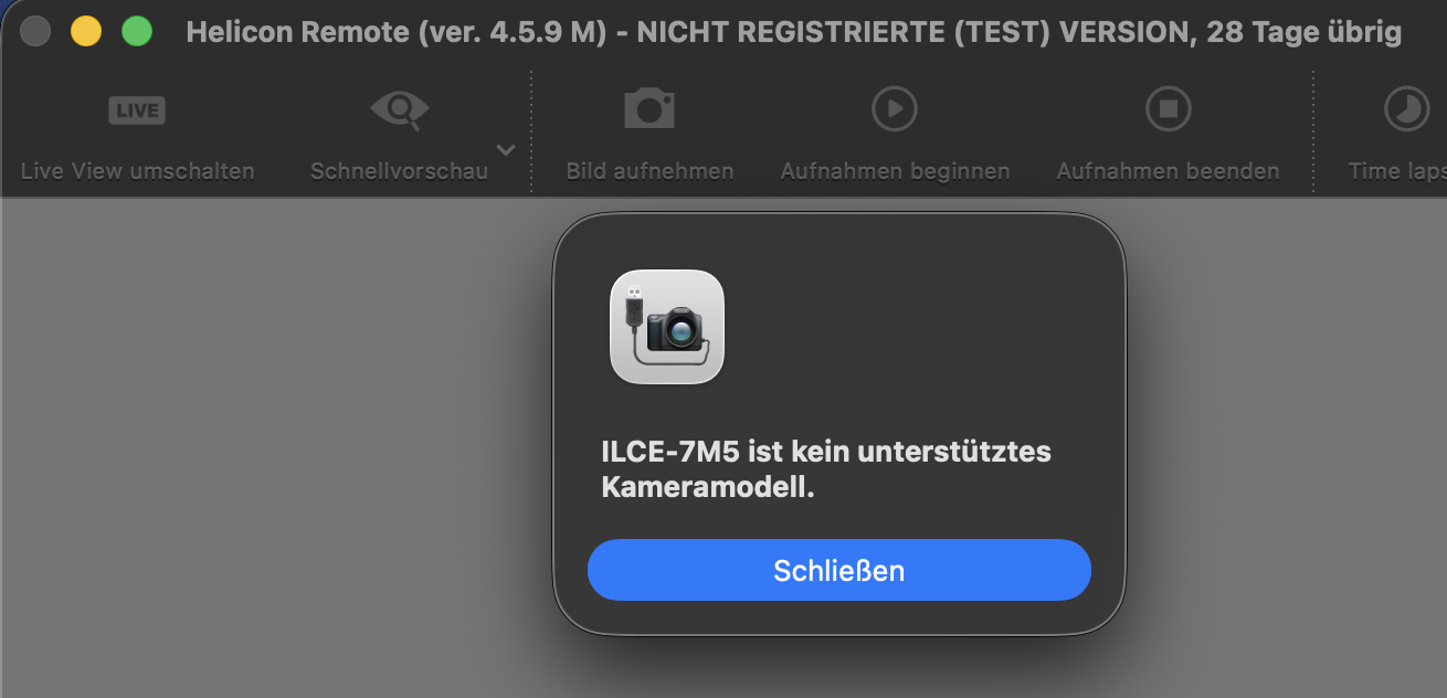

Any idea about the A7V? It's recognized but the message say unsupported.

It should work, get the latest version of Helicon Remote: https://www.heliconsoft.com/downloads/HeliconRemote.dmg

Thanks for the quick reply - I'm on the latest version and the model ist recognized by the Software but it says not supportet.
Any specuial settings at the Cam?
Best regards, Uli
Best regards, Uli

Hi Uli, yes, there's been a small confusion: the camera should be supported but it has been added just recently and the new version is not on the website yet. Sorry about that! Please try this updated version.

Thanks for the great support - camera is connecting and working so far.

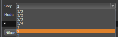

You can select smaller steps for exposure bracketing:

Sure it's possible to choose smaller steps but I#M forded to decide between 1 and 2 EV and it's not possible to choose 1,3/1,7 or whatever

Why not just shoot at 1, then?
Or, we could add more steps if you need them.

Why not 1? Because I want / have to shoot with 1,3 or 1,7 and not 1 or 2
I Think this would be an easy improvement - just gave us every possible stepwidth. Perhaps with one input field or clickable choise for full steps and another with 0, 1/3, 1/2, 2/3 ...

1 is less than 1.3, doesn't it mean that if 1.3 is suitable for your exposure bracketing scenario, then 1 is suitable too? You will just have 30% more photos to stack, but are there other drawbacks?

The only drawback is more pictures for the same dynamic range, that's right. But none wan's to shoot unneccecarry pictures, waste time with it and so get less bracketing sets in limited time (again very special usecase for sure) to stack afterwards. Additionally the more frames will result in more time für editing. Combining brackets from solar corona is a process with not much automation available for subpixel alignement etc.
But just an idea, it's up to you to decide whether it could be worth the effort ...

New version for you with more ev steps to choose from, please try it.

Wow, that's really impressive!
I tried 9 steps with 1,33 EV and there's a little bit strange ISO-Setting lowering from 400 to 320 at -1,33 and -5,33.
Trying to alter the value to 400 the app crashes - report send ...
