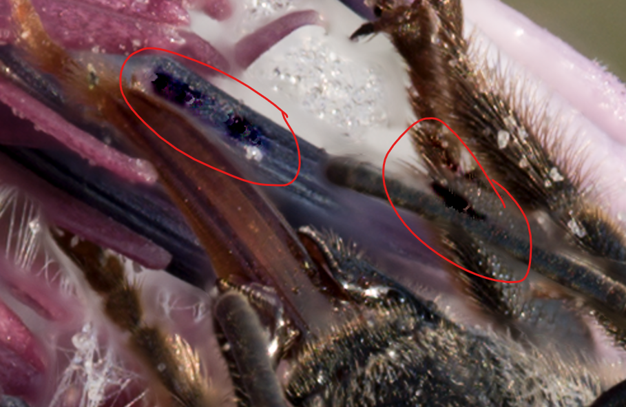

I noticed that when doing post‑processing with the “texture only” option, some strange artifacts appear.
You can find an example image attached.

Artefacts using "texture only"
- Screenshot 2026-08-25 204657.png (779.6 KiB) Viewed 941 times

I’ve uploaded the files. I also noticed that the issue mainly occurs when using small brush sizes (around 10%).

To give you a clearer idea of the problem, I have attached an example image showing the artifacts. It would be great if you could take a look and share your thoughts on this.

Sorry, I downloaded the stack but didn't try it until now. How do I reproduce this? I found the spot on your screenshot, but which rendering method, rendering parameters, brush parameters, brush type, source image if it's the "Copy parts from source image" brush (I assume it is)? I couldn't reproduce the problem so far.

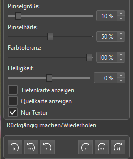

For the post‑processing I used the parameters shown in the screenshot. I noticed the following:
The problem occurs when you select a new image as the source and start retouching as soon as the brush is ready.
If you wait more than about 10 to 15 seconds after the brush becomes ready, the problem usually disappears.
The stacking parameters were B 7 3 and C 7.
