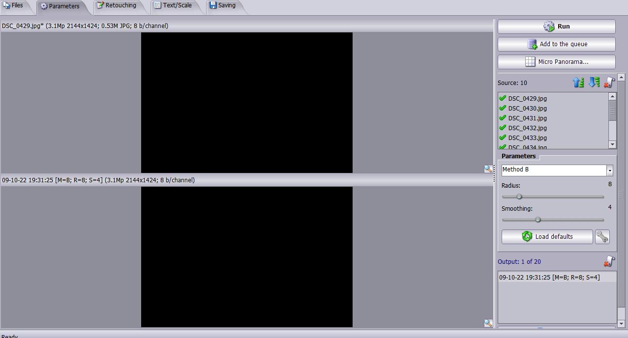

Hi all!
Have following problem: each time I try to process some images, I get totally black picture as a result (see screenshot). What I do wrong?
- Unbenannt.JPG (73.18 KiB) Viewed 24048 times
Re: Black picture as result
Please install the newest 5.0 version and check if the bug persists:DC87 wrote:Hi all!
http://www.heliconsoft.com/focus_downloads.html
