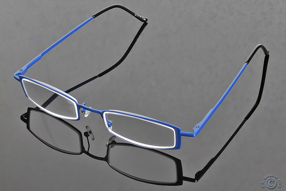

Hi ! I'm trying Helicon Remote and I would like to know HOW MUCH each figure in Distance between shots represent in milimeters or centimeters ?
I'm using a Nikon D700 with a Tamron SP90 macro set at f/16, and I found that, at a distance (nearest) of 55 cm., with an object of 18 cm. "deep", I needed 13 shots to get the whole thing sharp ! I used 15 as "Distance between shots" !
Below's the eyeglasses I shot with Helicon Remote ! BUT... I'd still would like to know what the "Distance between shots" correspond to, or what is the ratio to apply ?!?
Cheers,
J-P.

We measure distance between shots in focusing steps. There is no simple way to translate it into mm or cm because this depends on the lens type, aperture and distance to the object. You may find DOF calculators online. Still, they will give you only a rough estimate and you would have to check it anyway.
I would suggest to use the value from DOF calculator of Helicon Remote as a starting value and by find the correction factor for your lens. Once you found this factor, the DOF calculator will give you quite exact estimate for a given aperture.
