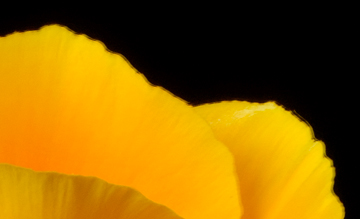

1. i'm very new to helicon focus and in general have gotten good results. however, i've had problems with this photo due to the problematic edges (i'm not sure what you call it).
2. i have the pro version and thus can theoretically touch up the image, but haven't figured out any easy way to fix this problem. any suggestions much appreciated.

- example image
- Focus Result 1 (B, 8, 4).jpg (49.62 KiB) Viewed 2685 times

Most probably this blurred edge is the result of the movement of the flower or the camera. The program aligns the frames but some parts of the flower cannot be aligned because they moved. You can easily identify it if you quickly view all source images one after another. You will notice movement if it is there.
Retouching brush is made for similar cases. Go to retouching, select "Clone from source image" brush. Then open source image where the edge of flower is shart. Then apply the brush to clone from source image to result. That is it!
