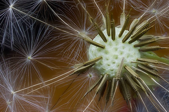

First time I've messed with the program, it's pretty sweet so far! Is there anything to get rid of the halos around some of the object, mostly the thicker straight lines of the seeds? I tried Method B with several different Radius and Smoothing settings, and also some of the depth smoothness and cubic settings in preferences and it just could not do the blending very well (waited like 1.5 hours on one and it looked worse...lol), even though they were in order from front to back, lots o smearing in the fine details. I used Method A for this and it looks the best and the settings were radius 3 smoothing 5, is there something I could do in post processing...I decided to not mess with that yet. Thanks!
Maybe I'm simply asking too much with those really small details like that, oh, and it's a 43 image stack.

This is difficult case because many intersections. We will send you a beta version of new version of Helicon Focus which will work faster and has some enhancement for such cases. I would recommend to use smaller radius with new version. I would also appreciate if you upload this stack to our server so we can use it for our internal tests (as described at http://www.heliconsoft.com/ftp.html)
