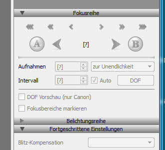

Just updated the complete helicon focus series including remote control. My Cognisys StackShot module does noet work any more. The display of the StackShot shows that it is connected and controlled. The programme window of Helicon Remote shows that the stepper motor is recognized but the controls for a focus series are greyed out. Last version working was Remote 2.2.5w beta. Please find attached the logs.

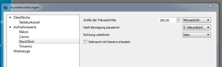

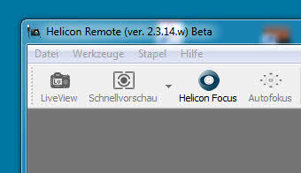

this is taking too long - I always have updated to the latest version via the the update pulldown menue. Please find attached some jpgs giving you all the necessary information. I cannot understand that I still have a Helicon Remote beta!
Again: before updating the to this version of Helicon everything worked fine. I just control the StackShot without camera.
Can you please fix this situation asap - I had sent to you all the logs in December and nothing happened.
Klaus
Klaus

Re: StackShot & helicon remote 2.3.13.w beta
Please download new version:
http://www.heliconsoft.com/downloads/He ... usBeta.exe
Wow that solved my problem - thanks. The Stackshot can be controlled again.
