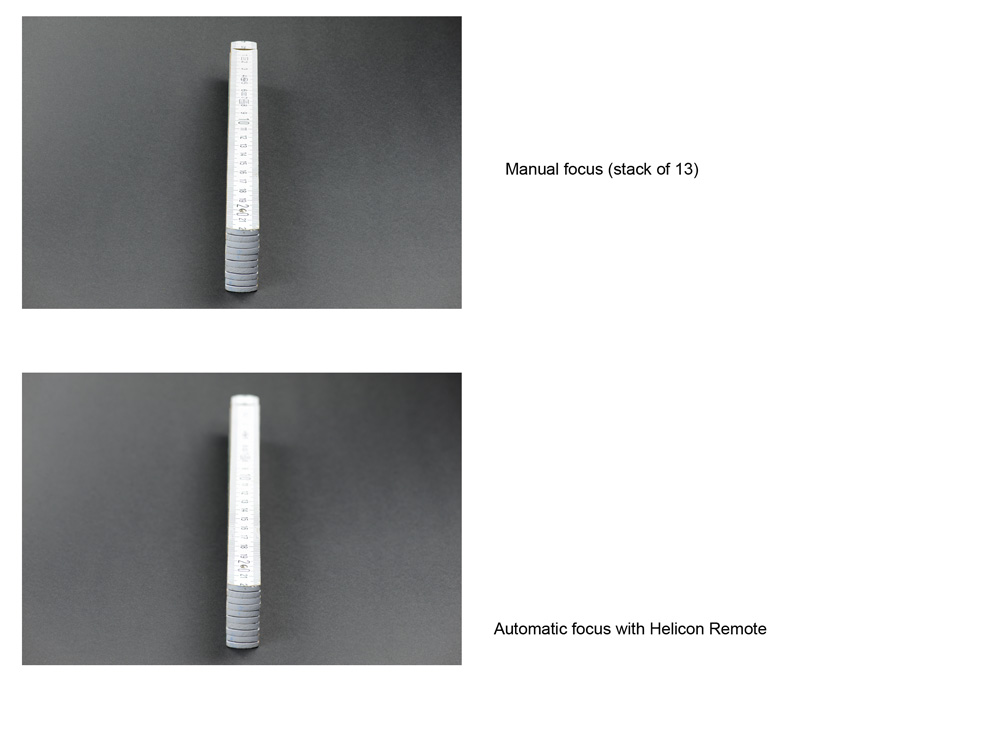

Dear Stas,
I need your help.
Please take a look at the attached picture. Both are results of Helicon Focus.
When working with Helicon Remote (Mac version, Nikon D3), I activate the autofocus on the camera, and then I mark the nearest and the farthest points (A and B). I lock both positions. Camera focus works fine with Helicon remote when I hit the "<" and ">" buttons.
When I then start taking the pictures, it seems that everything is fine at the beginning, but then (after about 3 pictures) the lens focus goes back to the beginning, it does not move to the point that I had saved as "B". "Auto" next to the DOF button is activated, all values are set to standard.
The same happens when I use the latest Windows versions of Helicon.
What do I do wrong? Both stacks consist of 13 pictures.
Thanks a lot for your help.
Regards
Stefan
Helicon Remote and Nikon D3
- See both examples (manual and automatic)
- Helicon.jpg (96.91 KiB) Viewed 4809 times

Hi Stefan,Stefan_R wrote:Dear Stas,
I need your help.
Regards
Stefan
