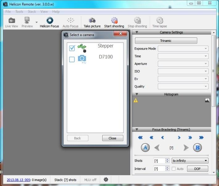

Test Helicon Remote 3.0.0.w and Motor Trinamic With:
Motor Trinamic
Nikon D7100/USB cable.
Connecting the Nikon D7100 and motor Trinamic not happen automatically.
Example 1:
- Engine power and Trinamic USB-RS232-WE-1800-BT_0.0 connected;
- Nikon D7100 ON and connects with USB cable;
- Launch of Helicon Remote.

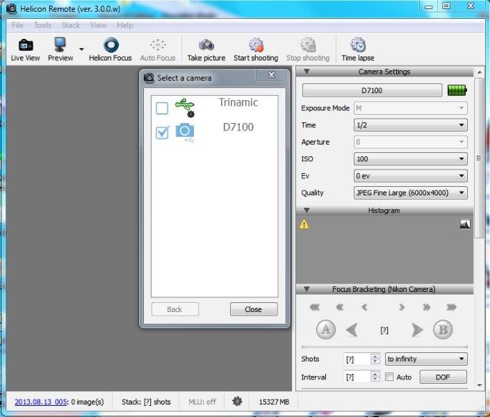

Example 2:
- Launch of Helicon Remote;
- Motor Trinamic ON and USB-RS232-WE-1800-BT_0.0 connected,Tick the box-Trinamic (which becomes stepper?);
- Nikon D7100 on and connects with USB cable;
But how you made the connection you may have 2 D7100, 2 Steppers, 2 Trinamic ….
However you should always activate an item or two, stop, restart Helicon Remote.
It should however know this operation to avoid no connects problems ..

Re: Test Helicon Remote 3.0.0.w with Motor Trinamic
As you've already figured out, a camera is connected to Remote automatically, but Trinamic isn't. You should tick it to activate it. Unfortunately, this change isn't reflected in the user manual yet, we're working on it.
We will support COM port connection for Trinamic eventually, but it's not top priority at the moment.
