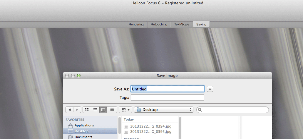

Mac OS X 10.9.1. This happened on earlier versions too.
I add the two files by dragging / dropping them on to Helicon Focus' canvas area. I click Restore defaults then render. Once done I click the Saving tab then Save...
I get the file name Untitled as per attached.
