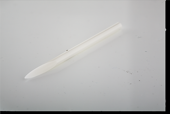

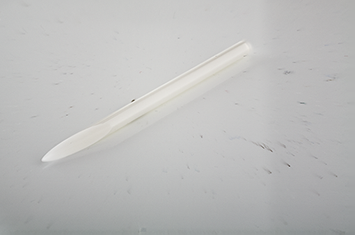

I take pictures from a Needle about 2cm. I use a 105er mm lens on a Fillformat 12 MB-Sensor. The Distance is 30 cm, the steps 1mm different. Aperture is 11 as optimal aperture.
But the end will not be sharp. I tried method as best result on the same object, only litteler an radius 6 und smoothing 4. method c works better, but the result is grainy and with a gost-image. What can I do?
The result with method C.

The final result with method B.
Bildschirmfoto 2014-01-09 2.png (247.18 KiB) Viewed 2360 times

The first images clearly shows that stack is not properly aligned (see dust spots). Please upload this source stack to our server (as described at http://www.heliconsoft.com/ftp-server/) and we would be happy to look into this problem.
