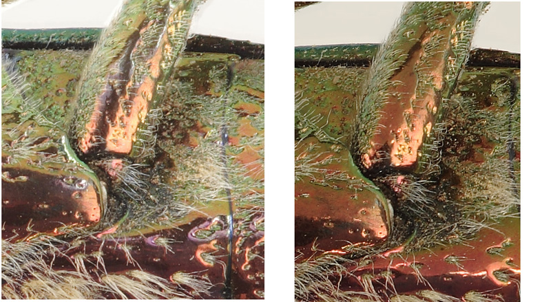

I have had the use of a Manfrotto 454 sliding micropositioning plate for the past two days. As can be seen from the two compared images, 41 steps sure beats 14. The rail has a fine adjustment knob that moves the camera 1.25mm for every full turn. I have been using 1/8 turn between each take which moves the camera only 0.15mm.
There has been some discussion about this piece of equipment being very loose and jumping around all over the place. While this is true during adjustment, I have found that when tightened between each adjustment the camera has lined up perfectly for me ever time. I am using the unit mounted vertically on a copy stand. There is no slip when the locking knob is loosened even with the downward weight of the camera and macro lens.
Segments of two Jewel beetle photos. 14 Stack on the left 41 on the Right.
14 vs 41 Chalcophora_m_florentina.jpg (205 KiB) Viewed 11446 times
it looks like the lightening was changed too....
The difference is too noticable, especially reflections round hairs

Dan Kozub wrote:it looks like the lightening was changed too....
I also noticed this in my initial tests using a ring flash and a focus rail. Each turn puts not only the camera; but, the light closer to the subject. I then purchased a duel light system and, when mounted on the camera it exhibits even greater changes to the lights as the camera is moved.
I've just purchased a standard light bracket to go UNDER the Manfrotto rail. I'll mount the duel flash on the bracket so that the lights won't change position as the camera is moved back and forth. This means, however, that it will be important to ensure that the light is not blocked at all by the camera as it moves forward.
