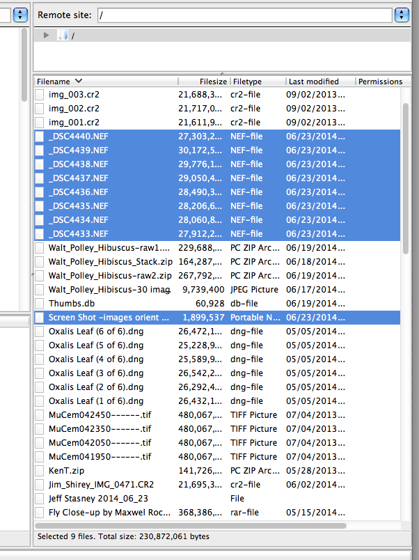

I just downloaded this version 6.1, and tried importing a stack. The images are portrait orientation, but when I import them, they all turn sideways-landscape orientation. How can I fix this? Thanks
Re: Files change orientation when imported into Helicon Pro
We need to test your files in our environment. Can you please upload them to our ftp server as described at http://www.heliconsoft.com/ftp-server/
Thanks, I uploaded them to server see attached.
Jeff
Jeff
- Screen Shot 2014-06-23 at 7.18.35 PM.png (182.46 KiB) Viewed 8305 times
Thanks for your images. We were able to reproduce it. We will try to fix it asap.
