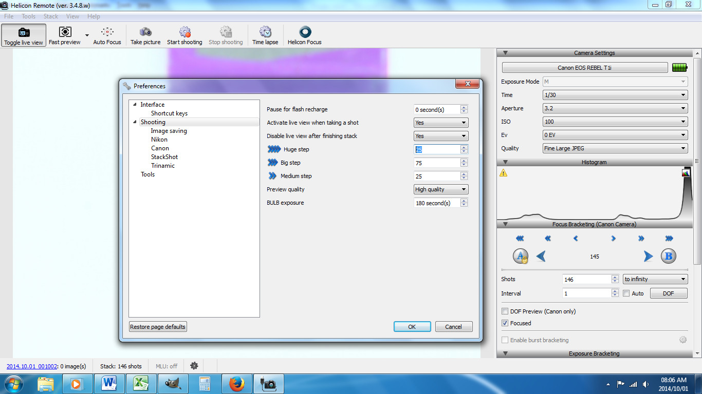

It didn’t help though. I played around a bit and I think I found the problem (or more likely the origin of my confusion). In the attached screenshot you will see that in the “Preferences” box there is “huge step, big step and medium step” with four, three and two arrows respectively. In the “Focus bracketing area” there are three, two and one arrows. It seems that the number of arrows in “Preferences” corresponds to the number of arrows in the “Focus bracketing area” so only “big step and medium step” can be changed with small step defaulting to a single step.
Some where I have my settings wrong and I don’t know how to fix this.

There's nothing wrong. Small step is one unit of movements (these are conventional units, not a fixed physical length). And then you can adjust medium, big and huge steps. Huge step can only be performed with a keyboard shortcut, there's no button for it on the Focus Bracketing panel.
