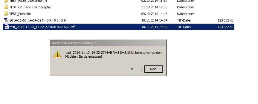

When I retouch and want to overwright the already saved picture from an enqueu stack I get a failure message. To save it in a new folder does not make any problems. Because I stitche the pictures later it is important for me to have ascending or descending order in the filenames.
The saved files (TIF) after retouching do not open in LightRoom. You can open it in PS save a copy and then open it in LR. I put the files to the FTP.

I enqueue render about 72 dng pixtures and save them to a folder.
Some of them I retouch and want to save them to the same place with the same name as the automated enqueu saving of the picture.
But then I am not allowed to overwright it...
Saving them to another folder ore using a different name is possible to save them but results in the problem, that Lightroom can not open the tif.... See other tread.
If you want I can upload all pix ore make you little screenmovie...
I have the same issues,when I stack only one picture... see attachments..

Very strange. Why the program looks like under Windows XP? Do you have XP style active or the program is run in compatibility mode?
Re: Saving Problem after Retouching
Posted: 18.11.2014 13:04
by danibo
it is 100 percent Windows 7
where can I check the compatility mode is on or of
