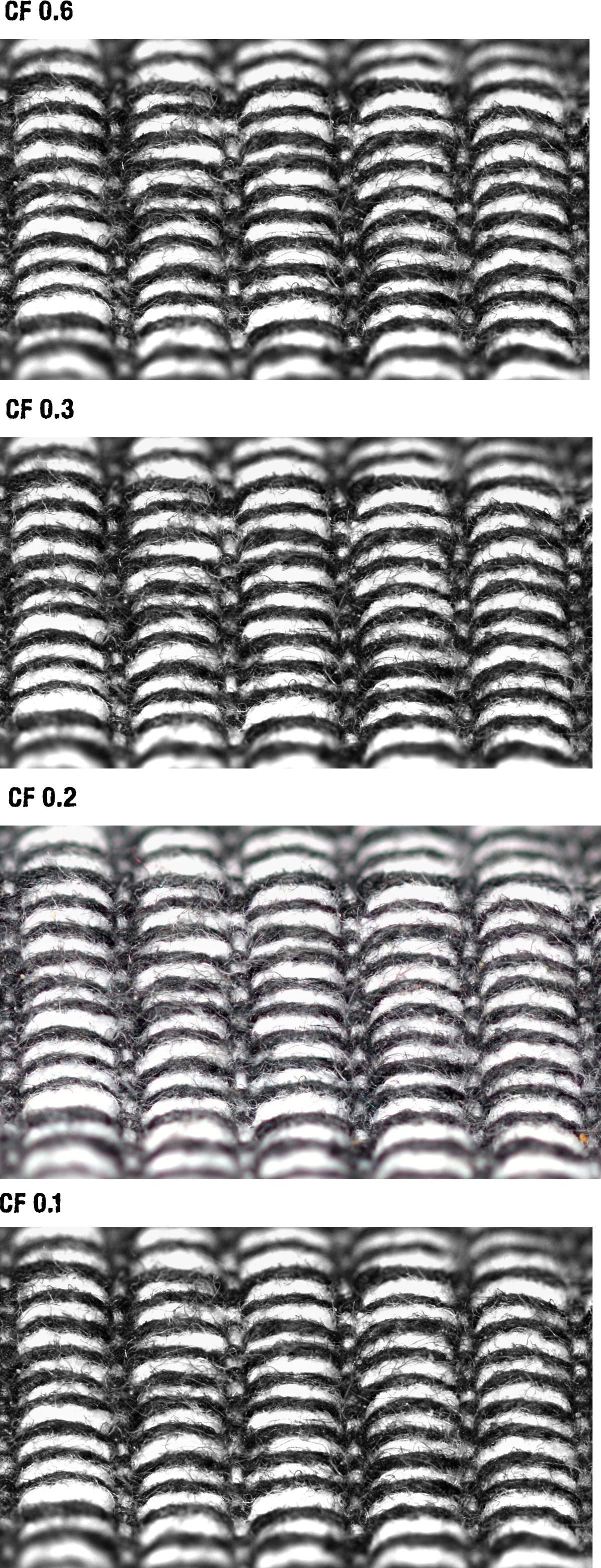

I've been trying to take shots of flowers with Helicon Remote and Focus with my Canon 6D and EF 100mm f/2.8L. I seem to be having problems with the correction factor (if I've read the boards correct). I've tried to set different correction facors from 1 down to 0.1 and cannot seem to solve the issue of areas of softness in the final stacked image. What am I doing wrong here?
I've done the correction factor testing in the manual down to 0.1. Should I really need to go any lower? What correction factors are you other guys using?
I am using Big Steps in the Focus Step Size. But switching it to small can't really be an option for flowers right? That would be a lot of åictures for one flower. But maybe that's what I need to do?
Does anyone recognize this issue?
Including 100 % crops of images with different correction factors.
Thanks for helping out!
/J
CF tests
(2.47 MiB) Not downloaded yet
Re: Canon 6D + Canon EF 100mm f/2.8L
You need to go higher, not lower.
