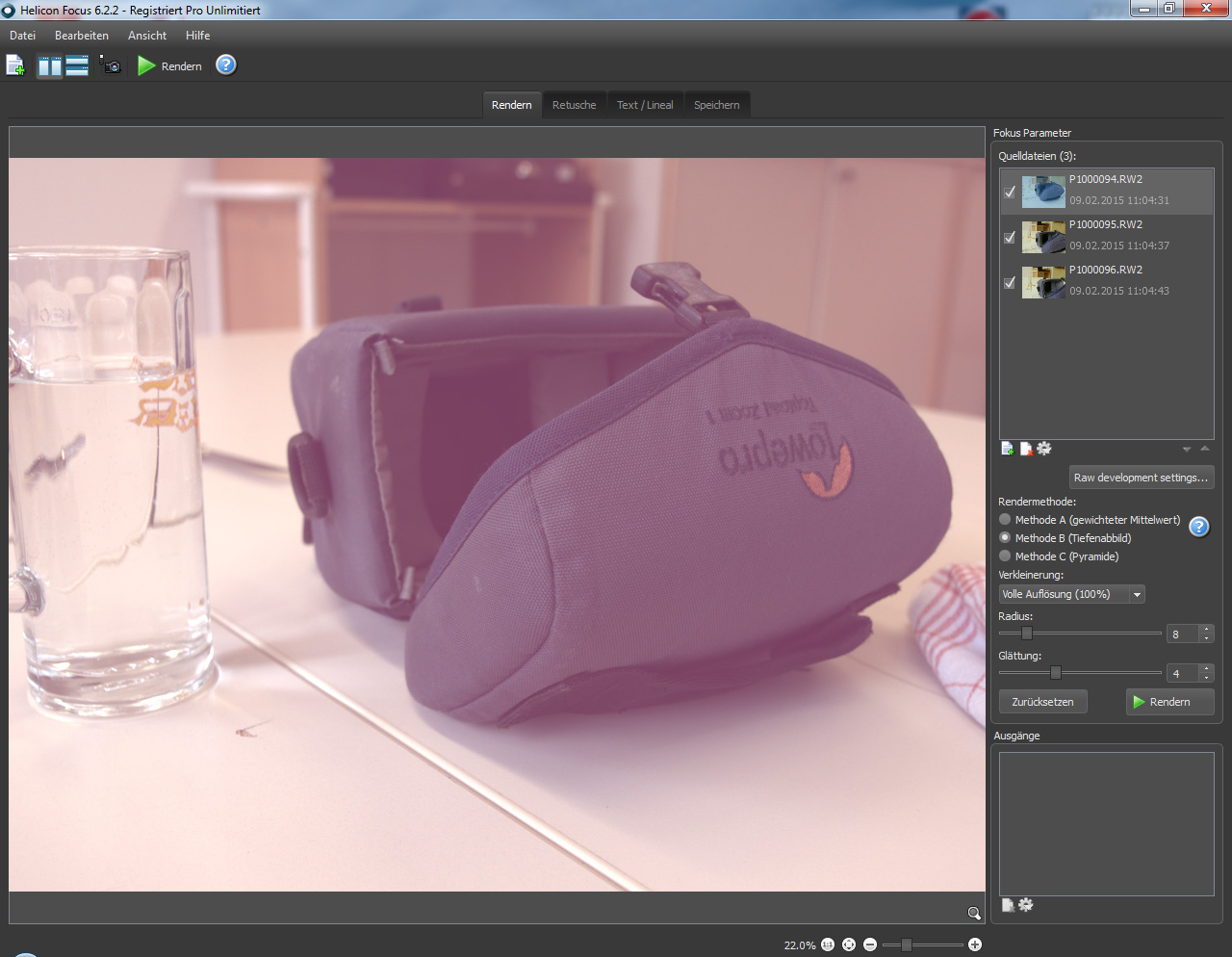

if i´m importing raw files from my lumix gh4 in helicon Focus they all appear pink.
does anyone know what the Problem might be? or do i just need a extra raw plugin?
I use Version 6.1 pro

I have now updated to Version 6.2.2 and I have still the Problem with this pinkish fog (see attachment).
Have you any idea what this can cause?

I think this depends on RAW development setting in Helicon Focus. In the RAW development settings under Source image list you are able to choose RAW engine and its parameters.

Please try newest 6.3 version. We added new RAW-in-DNG-out loader. I may render your files better. And even if rendering is still wrong, you can save result to DNG file and render it in your favourite RAW engine as you like it.
