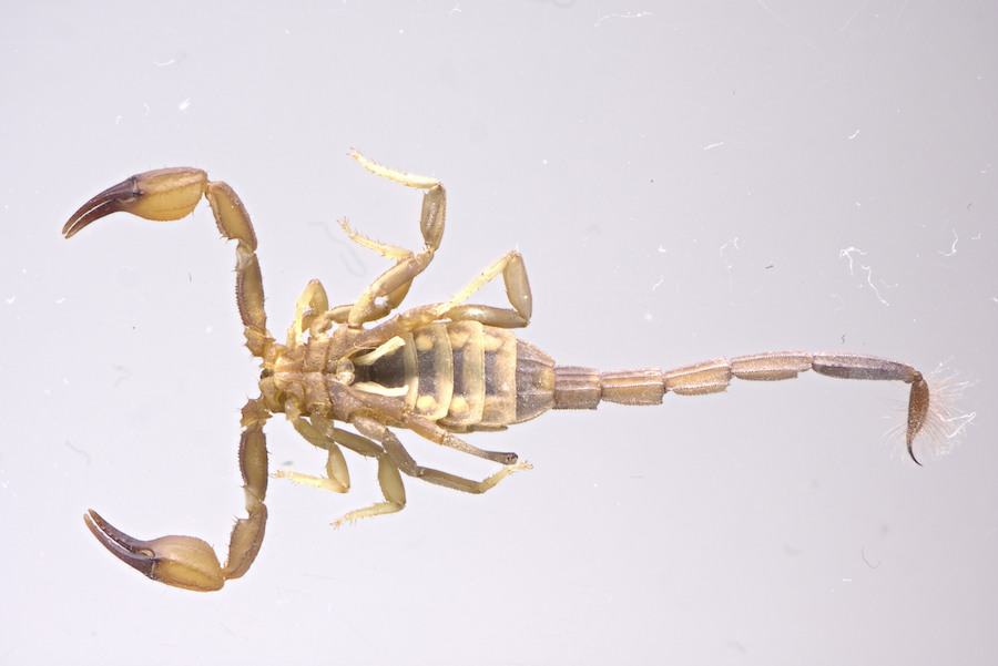

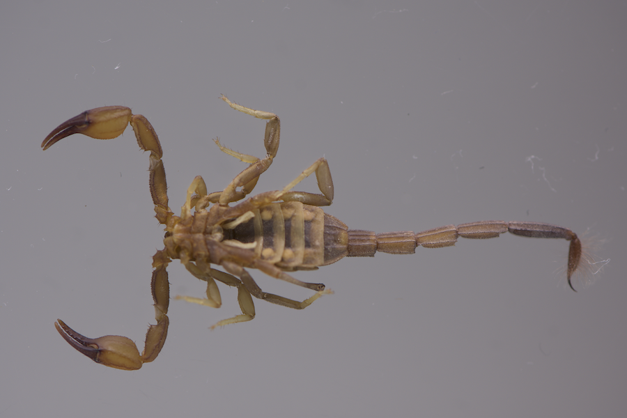

When I run a stack through Focus, the final image is very much overexposed, even though the individual shots are fine.The output looks the same no matter what setting I use in the creation of the stack. The attached single image is from a series shot at f5.6, 1/160 sec, ISO 100 RAW. The Focus settings were for method C
- Output.png (2.98 MiB) Viewed 8024 times
- single.png (2.86 MiB) Viewed 8024 times

Hello Mike!
The exposure is changed by default option in DCRAW converter (clip highlights).
If you change this option to unclip or use different RAW development engine, you should not have this effect.
You can change these parameters under source image list (RAW development settings).
You can also install Adobe DNG Converter: http://www.heliconsoft.com/adobedng/
and setup the path to DNG Converter in Helicon Focus menu "Edit / Preferences... / Integration".
