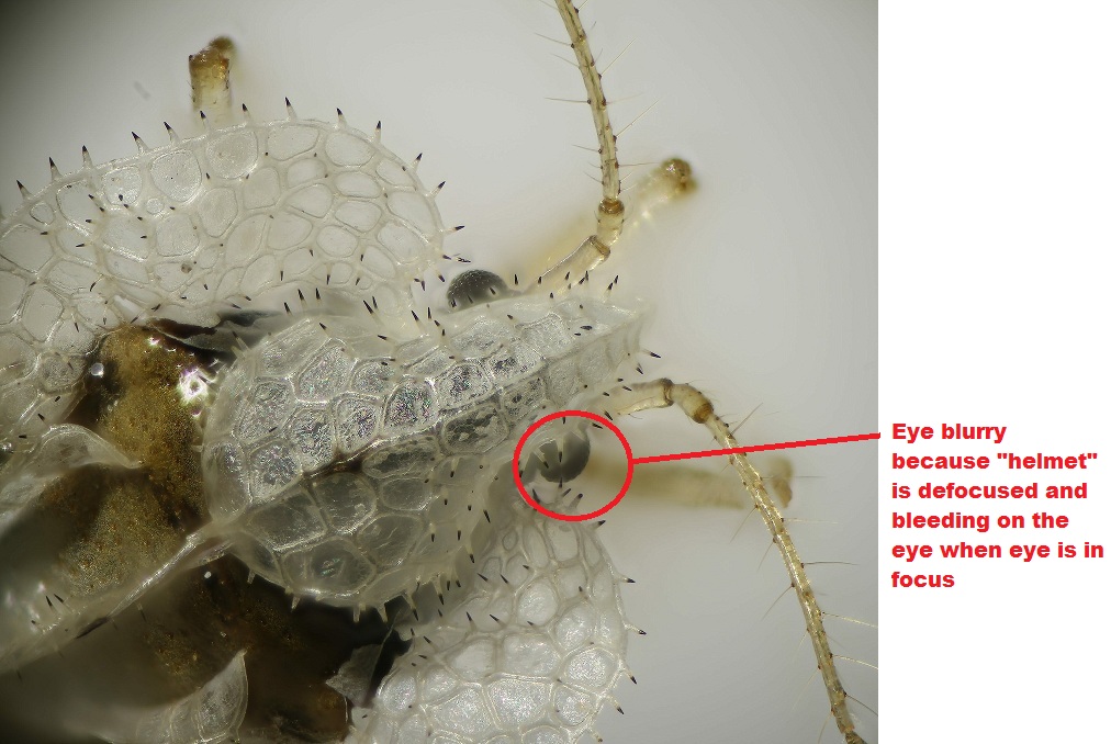

I'm making microscope pictures of an insect and I can"t get is eyes correctly.
The "helmet" is closer to the objective than the eyes and when the eyes are in focus the "helmet" is defocused and bleeding on the eyes.
Is there a workaround?
Note that this is a microscope so I can't change the aperture to get a different depth of field.
Thanks.

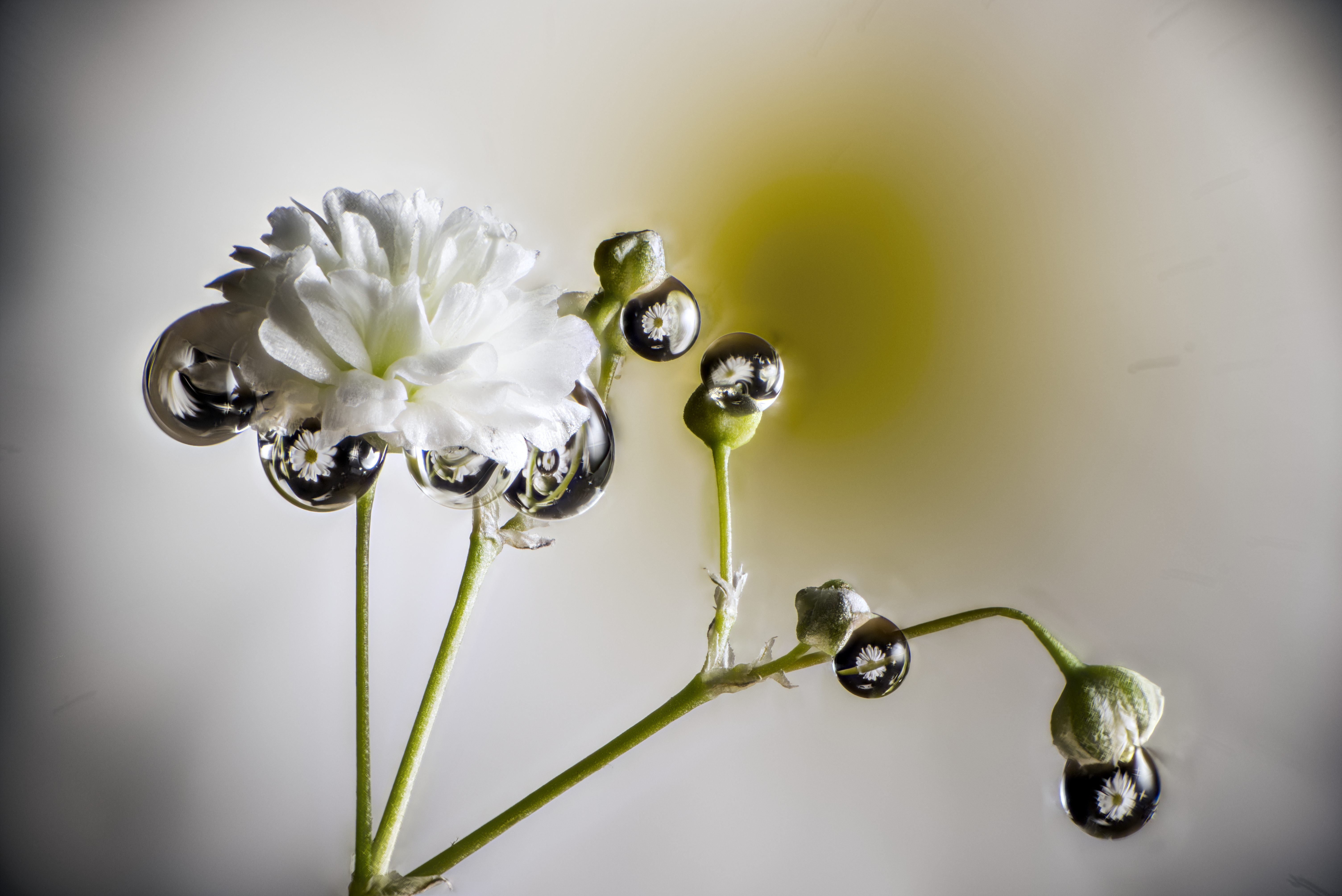

I was wondering if you guys came up with a suggestion / answer re this issue. I am having the same issue when the foreground object "bleed" into the background objects. I also have an issue of a "glow" which seems to me to be the same issue - when the object is out of focus it appears to be bigger than when it is in focus. So there is a soft glow around the sharp image (see example below - glow around the stem that is directly in the center of the photo as well as around the droplets).
Any feedback would be most appreciated!
- (1.74 MiB) Not downloaded yet

Hi Stas - I have uploaded the stack as JPEG files - they are on your ftp site inside the zip file called "DSC_7155 BLURB.zip". (ftp://217.12.211.23/)
Re: How to deal with foreground object?
Thanks for your images. This is mostly due to optical effect. I would recommend to decrease aperture to f8 or f11. This will also help to remove blurred areas which appear because focused areas do not overlap sufficiently.
From our tests, method C gives best results for the current stack.
