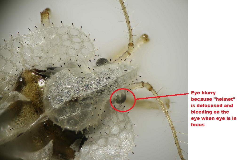

I'm making microscope pictures of an insect and I can"t get is eyes correctly.
The "helmet" is closer to the objective than the eyes and when the eyes are in focus the "helmet" is defocused and bleeding on the eyes.
Is there a workaround?
Note that this is a microscope so I can't change the aperture to get a different depth of field.
Thanks.
