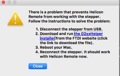

But I keep getting this error message, which leads to the installation of the FTDI driver.

Re: FTDI driver
Now I see what you mean. That's not really a driver, on the contrary - it's a dummy component that does nothing on itself and prevents Mac OS from loading an actual FTDI driver - because that driver will break Remote (and many other applications that use FTDI).
So you've followed the on-screen instructions and it didn't work?
