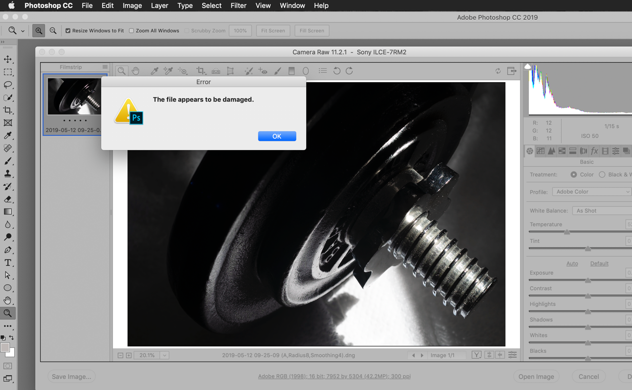

I am getting the same message when I open a file exported as DNG (see attached file ScreenShot.png)
I am using Photoshop on MacOS, which opens the exported DNG file in Adobe Camera Raw. No matter how many times I export the file, when I try to open it the message appears. When I try to save the file from Adobe Camera Raw, the process fails with another message the the file is damaged.
This is a serious bug: one of the compelling features of Helicon Soft is the ability to import a series of RAW files and export the file as DNG. With this approach we can apply corrections to the final DNG file (such as lens profiles) instead of having to apply all corrections to the original RAW files. This is very convenient, a time saver.
I have placed a copy of the broken DNG file at www.kennethleegallery.com/images/helicon/Broken.dng
