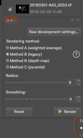

Re: HF 25% slower on 10 core iMac Pro than 6 Core Mac Pro
Thanks, trying it now. What is the difference between the two Method B's? (depth map and legacy)
- Posts: 3833
Depth map is a new experimental method. You can compare it with the old Legacy method.

You can speed it up even further by in-ticking "Show intermediary results" in the preferences.
And yes, thanks for pointing out the small icons, we're aware of it. It's work in progress.
