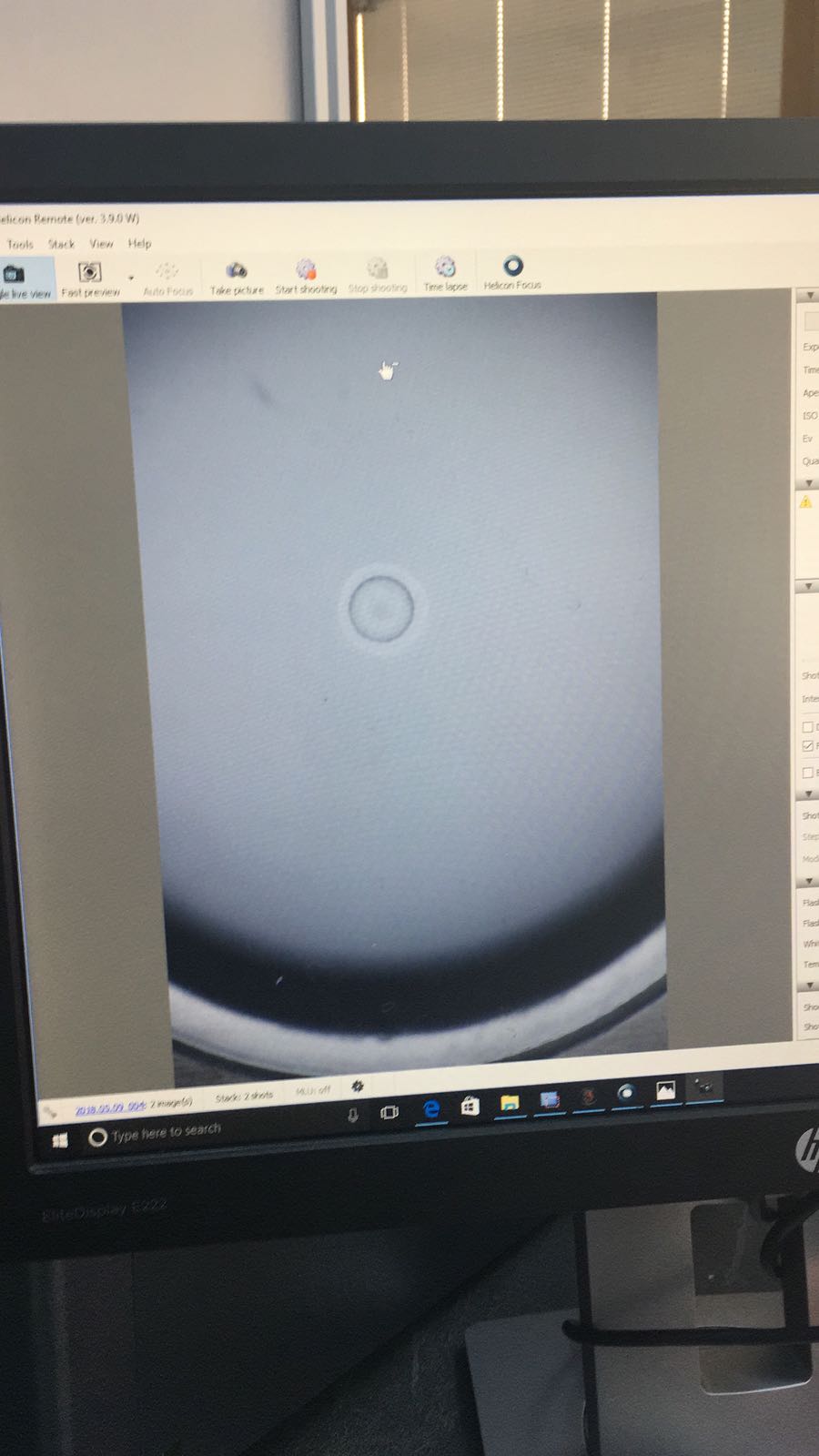

While using Helicon remote toggle live view section, my viewing size on the screen is changed automatically. I need wide screen. How can I convert it to the wide screen?
Changing the Size of Toggle Live View Screen

The image was rotated for your convenience based on what the camera's orientation sensor is reporting. You can go to Helicon Remote settings -> Live view and set "Live view rotation" to "Disabled". Or you can disable the orientation sensor in the camera body.
