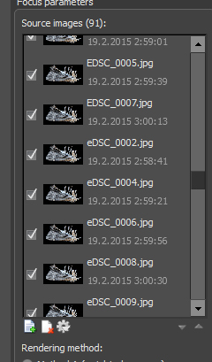

I experience the same problem, images imported by selecting as you described (click first, ctrl+click last, drag into HF) - not sorted either by date or name...see the attached screenshot.
not sorted.jpg (84.75 KiB) Viewed 5629 times

...so I have solved mine problem - the problem was that there was "e" as the first letter in some of the jpgs and "E" as the first letter in others - HF is obviously distinguishing them...so actually sorting works in my case, only the sorting rules might be somehow uncommon. Alex
