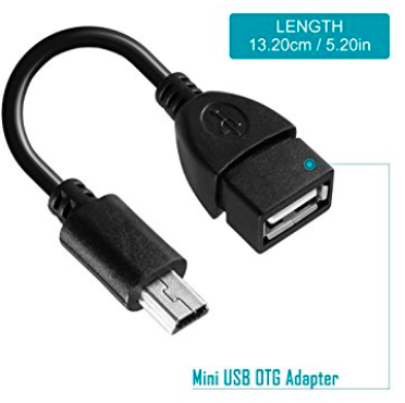

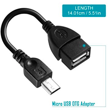

I've got a new Galaxy Tab A (Android 5.1.1) and connected it to my Canon 80D with a OTG adapter (attached)
with the cable that came with the device. Helicon Remote doesn't recognize the camera.
When I use the cable that comes with my Canon 80D and use the other OTG adapter, then Helicon Remote recognizes my camera.
Here is the problem:
Helicon Remote on the Galaxy tablet controls all the functions of the camera BUT it doesn't show the Live preview on the tablet.
It only controls the LiveView on the camera. If I connect my camera to my laptop with a USB cable, LIveView on the camera is disabled while Helicon Remote is running and works as it should.
Any ideas?
Thanks!
Galaxy Tab A connection
- Screen Shot 2017-12-30 at 3.33.37 PM.png (96.55 KiB) Viewed 5393 times
