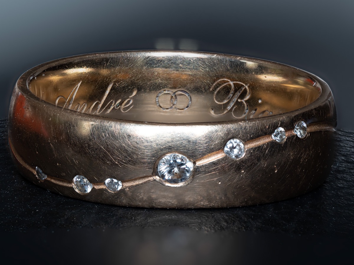

I download the demo version of Helicon Focus to try the possibilities of the software. I use a tripod, macro rail and the camera internal focus stacking function. The results of all three algorithms was unusble. What did I wrong?
You can find the full resolution picture and the 50 RAW images in the following dropbox:
https://www.dropbox.com/sh/nvqxu31wlts6mee/AAAPiYs9dFpXQlB0l8R6-SApa?dl=0
My first try was useless
- D6955220-4E1B-4C07-8DDF-B2DC063E4CEA.jpeg (263.04 KiB) Viewed 22340 times
Re: My first try was useless
I’m not sure what you feel is missing. Everything seems in focus.

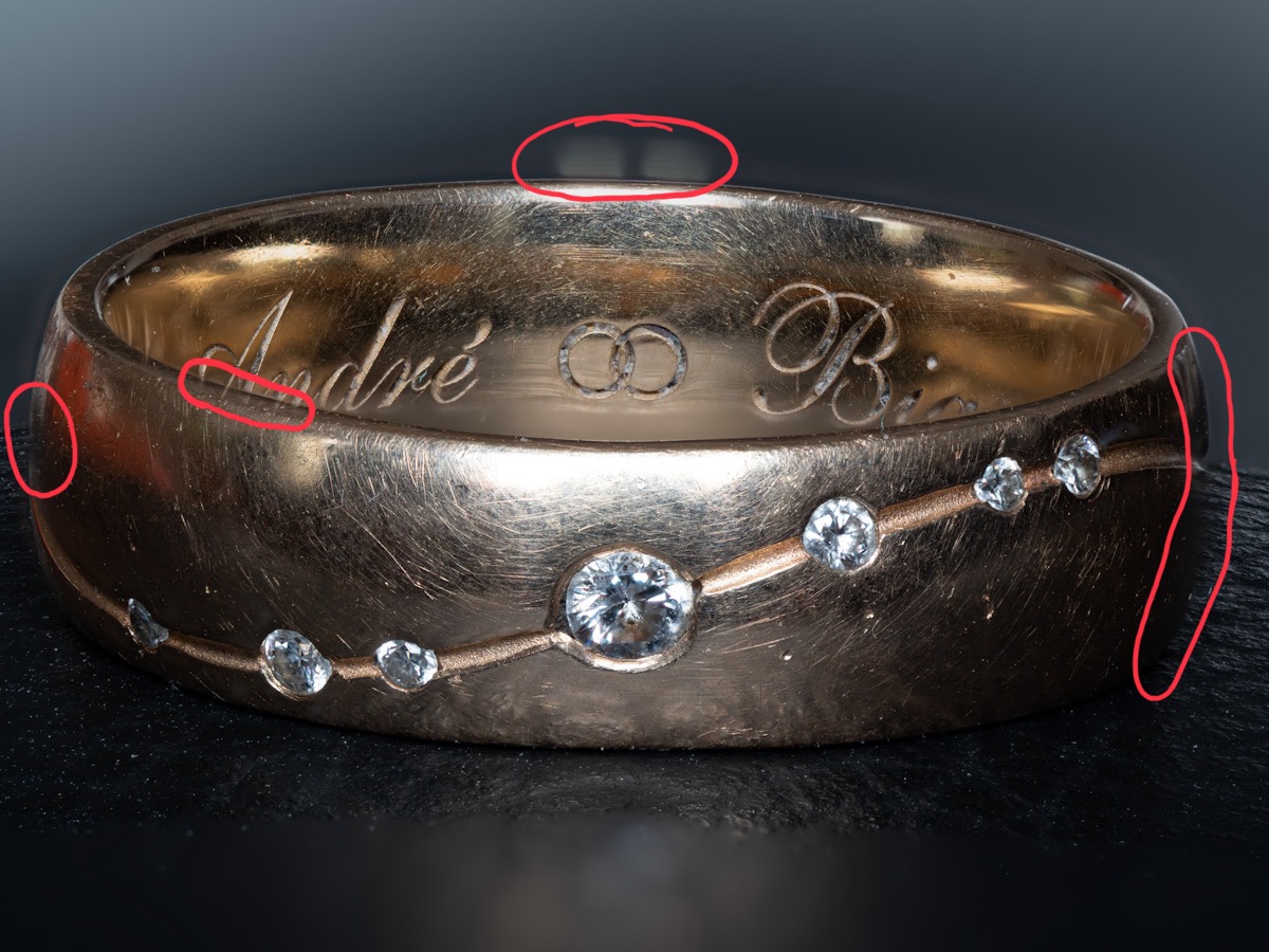

I mark the artefacts in the picture. Sharpness is not the problem.
- 4D4EBAD2-4582-4042-B0E1-5772744EA842.jpeg (270.75 KiB) Viewed 22335 times
Two comments, first, if they are the original jpegs they are of low quality. Second, the lighting you used is poor.
I would start by improving lighting and see whether that fixes some of the artefacts.
You need to get the overall process set up correctly, including lighting and jpg quality. Poor images in, poor stacks out.
The artefact in the middle at the back is caused by the strong specular highlights caused by your lighting, it is obvious looking at the individual images. You need to correct that aspect of your lighting by better diffusion or better placement of the light source.

I use the original RAW files (see dropbox link). The rail is only for focussing the first image in minimal focussing distance.
I will try it with less harsh light.

Legacy method B produces better results (you can enable it in Preferences). But we would suggest to set smaller aperture to minimize blurring of out of focus areas because now you can see optical artifacts which no software is able to completely overcome.
