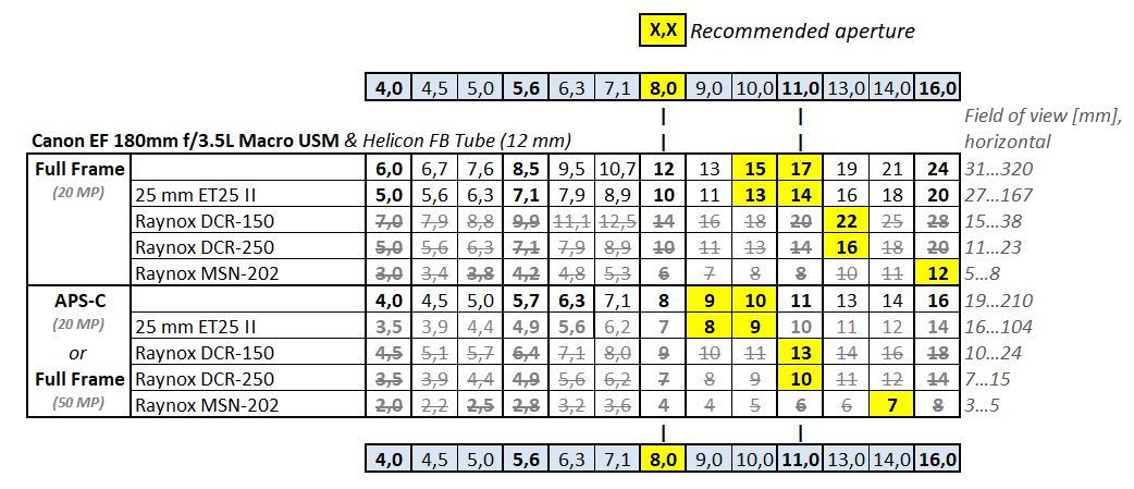

Whart is the Recommended Step Width for Canon Lens 180 mm Macro ? (For the 100 mm Macro II You suggest 21 if i am right, but in the Configuration List of Canon Lenses, the 180 mm Macro is not visible...)

Use step with 15 at F 10.
See as well attache JPG for combinations with RAYNOX macro lenses
