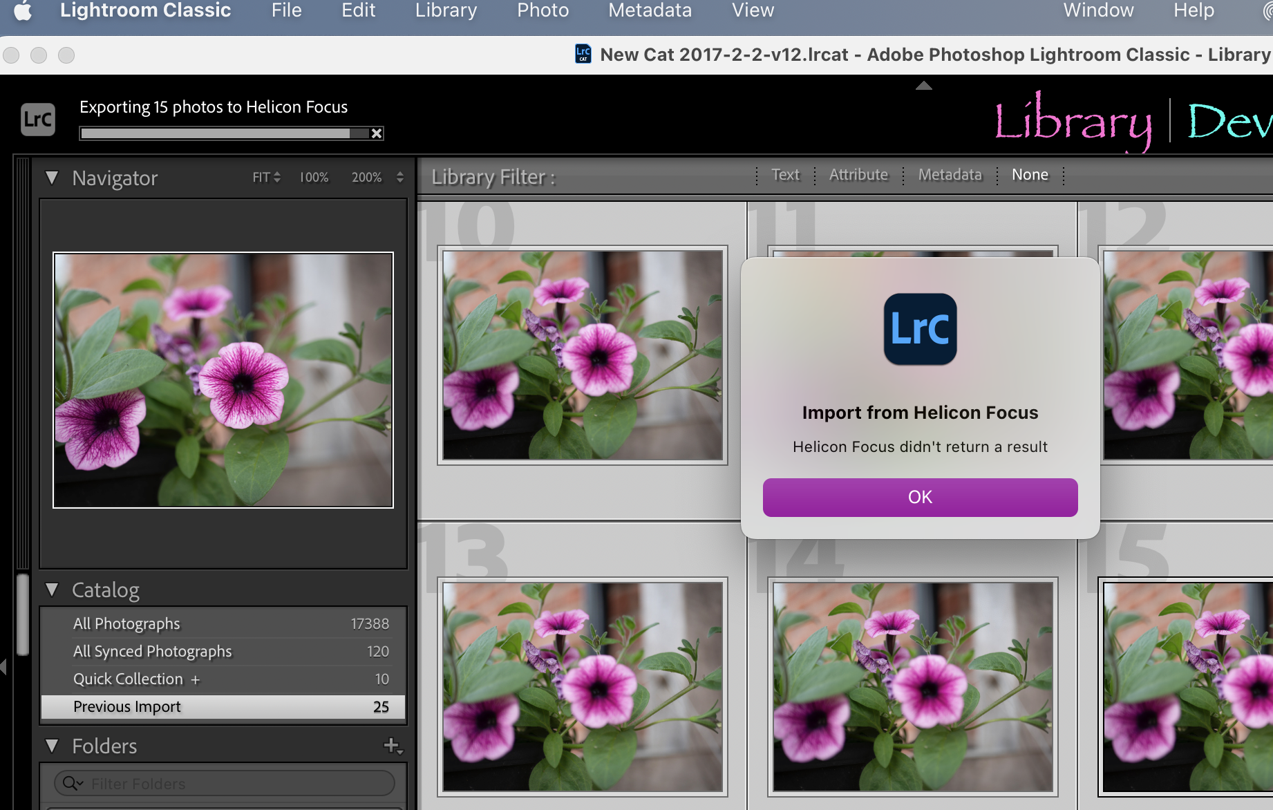

I have saved every time after render and then go to exit and a box pops up saying ' Some results are not saved. Exit without saving?' Lr is still showing the export/import is incomplete which saving option should I choose? I'm only using the trial version, would this make a difference?

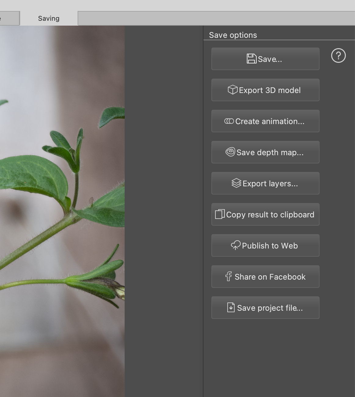

Yes, I followed the procedure. I have attached two photos to show what message I get and also the save option I'm offered, I chose the top one. Am I saving in the correct place? I am using Mac M1 chip, also non of the help (?) buttons work! should I do a reinstall as the programme isn't working properly? I am able to see the export option in Lr for sending to Helicon in both DNG and Tiff, I am sending Tiff.

Re: How do I get finished images to return to Lightroom?
The "Save" and "Save all" are the correct options. You didn't mention the "Helicon Focus didn't return a result" message - this narrows the problem down, but still it's an anomaly and shouldn't happen. Please run an export again, save the result (Cmd + S keyboard shortcut is the fastest way) and then, before exiting Helicon Focus, send a bug report (menu - Help - Contact support).

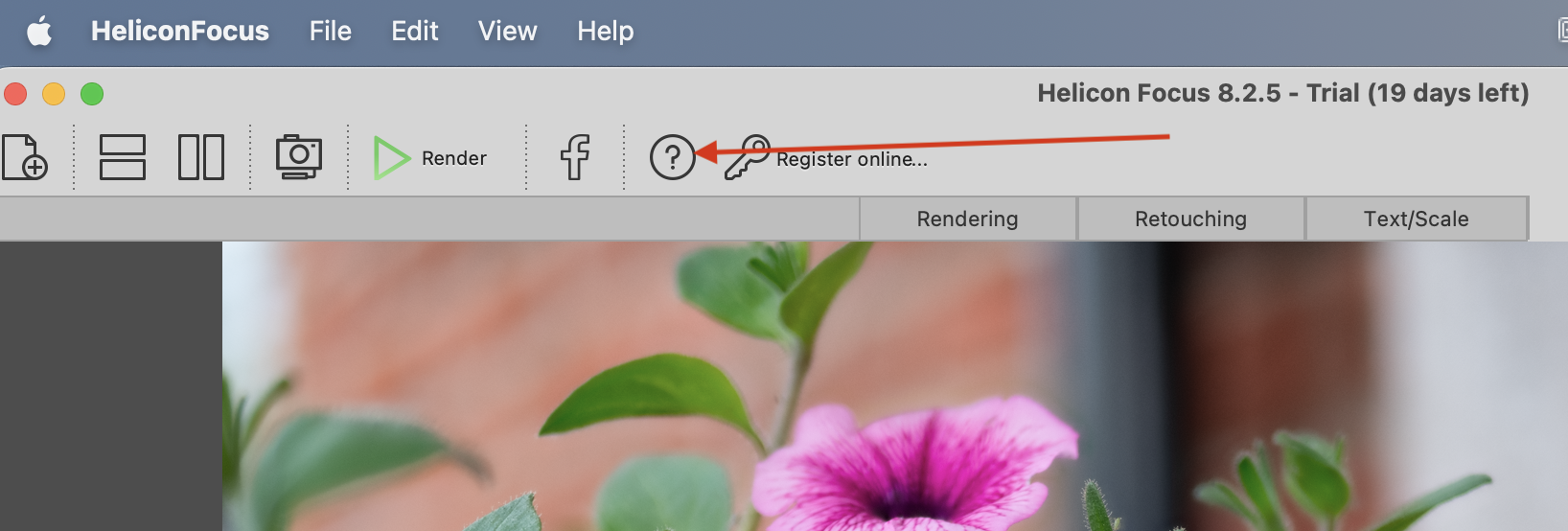

Which of the (?) buttons do not work? I've tried a couple and they all worked on Mac. They won't work if you have no default web browser set up, but I don't know if it's even possible on Mac to not have one.

I have been trying again today. Yesterday, when I saved it, wouldn't return to Lr but would save to file and I got the message "Helicon Focus didn't return a result" Screenshot is attached below.

This is the Message I was getting yesterday

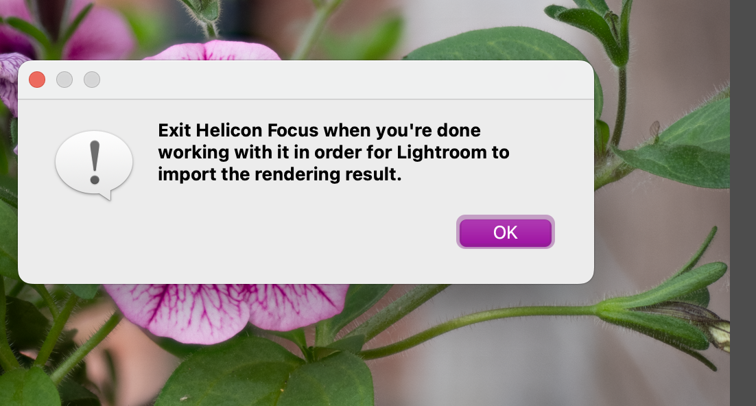

Today I imported images and after I saved I got the message 'Exit Helicon when you are done working with it in order for Lr to import the rendering result'. This was a new message so I exited and I saw it returned to Lr and was sitting next to the imported images in their file, so that seems to have resolved.
This is the new message I'm getting today,
Screenshot 2023-06-17 at 3.49.56 pm.png (703.53 KiB) Viewed 12828 times
The two help buttons still don't work, I have attached two screenshots to locate them. I have google chrome set as my default browser but I can to Safari if that will help
Dead Button
(786.9 KiB) Not downloaded yet
Happy to hear the export issue is resolved.
The "Exit Helicon Focus..." reminder should be displayed every time when you do an export and save the result. The fact that it wasn't displayed and Lightroom didn't see the result are probably related, but we have no idea what was going on there. If the saving process got stuck, then Helicon Focus shouldn't have just exited. Very odd.
