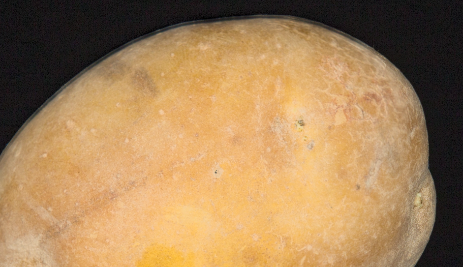

Out of 73 photos, 6 have errors. I’ve tried various settings, but nothing seems to help. What could be the cause of this?
I’m using a turntable, adjusting the focus with helicon remote, and taking photos — nothing else.
Photos:
https://imgur.com/a/C470JOC

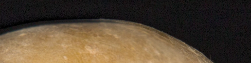

I encountered some issues with the edges of my model. In attached I giving a couple of examples with close-up and I'm curious why this is happening. Changing the settings didn’t help much—usually, increasing the radius worked for other images to make similar effects disappear. I'm not really sure what is cousing this error and how to avoide it in the future.
Re: Photo Errors on Turntable Setup – What’s the Cause?
I see, the fact that there is a double edge on the top, but the other sides of the subjects are fine, suggests that maybe the point of view changed during shooting, i. e. not all images in a stack are shot from the same point of view. Or maybe the subject has been moved. In both of these cases that's not a valid focus stack.

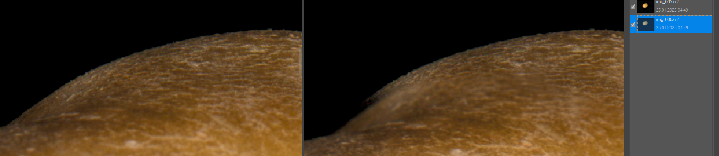

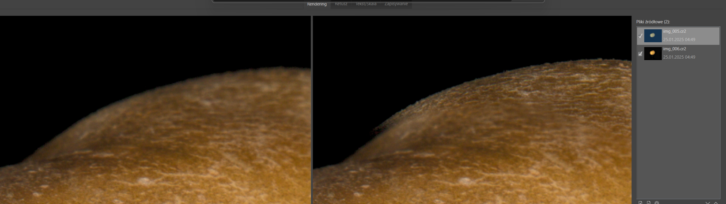

For example, these two photos. Why does this issue occur?
I can't completely eliminate it in hundreds of photos. A larger radius helps in most cases, but in this particular instance, a smaller radius works better. However, I still can't fully remove it.
Link to photos:
https://drive.google.com/drive/folders/ ... sp=sharing
(740.71 KiB) Not downloaded yet
(682.56 KiB) Not downloaded yet

I rendered the stack out of the 12 images you provided, and I don't get this artifact. And not with just the images 5+6 either.
Go to your Helicon Focus preferences - Autoadjustments, click Reset, then OK. Reset the smoothing and radius to their default values by right-clicking the sliders, and render again.
