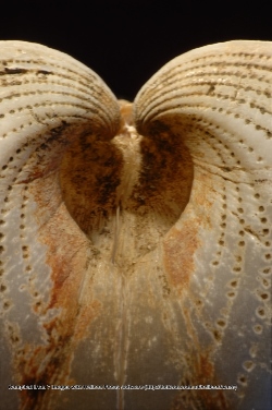

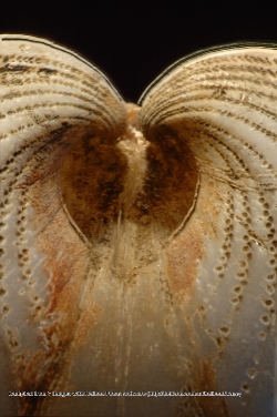

I have been evaluating ver. 3.10.3 (the current version), and found I was obtaining pretty bad results on my two PCs (a Compaq laptop and a Gigabyte desktop). Since my results were obviously not comparable to those I have seen in reviews of Helicon Focus on the web, I did some searching and came up with two older versions, v3.00.2 and v3.10.1. The first of these versions works fine, the second displays the same problem I got with the present version. By swapping individual files in and out, it seems that the bug is in focus.dll v3.10.1 and later. As soon as I drop focus.dll v3.00.2 in the v.3.00.2, I get the bug also in this earlier version.
Attachments are pictures reduced to 1/8 of their original size, made from the same set of 7 pictures, same default settings. Results speak for themselves.
Best regards,
ES
ES,
It seems that alignment does not work properly in 3.10 version.
I would need your original files to test the version.
Can you send them (resized version) by mail or upload them to our ftp server?
DAnylo
