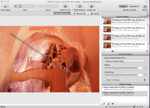

I just bought Helicon Lite and put the activation code in correctly, it was accepted but the program assumes I'm still on the free trail. Also I notice it's not been able to process the image anyway. This is a stack of 5 images and I used a reflector to bounce in light into a cave, the light changed slightly from image to image. Should this create a problem?

Lite license does not allow to run program in 64 bit mode. I think that is why you see trial mode watermark. Please restart the program in 32 bit mode (Helicon Focus menu\File) and see if this helps. If you have troubles with this stack, please upload it to our server (as described at http://www.heliconsoft.com/ftp.html) and we will see what is going wrong.
